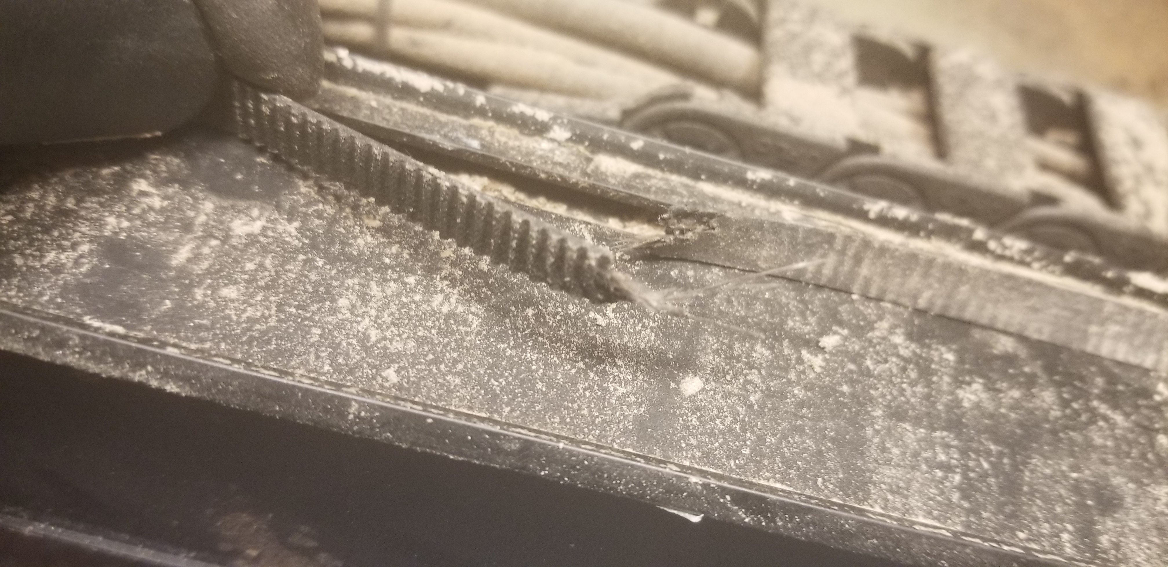

I’ve had my machine for over 6 months and have not had a belt break.
Take a picture look down into the Xcarriage showing the X stepper pulley and belt.
Do the idler wheels turn freely?
It looks like its riding the outer edge of the idler and the stepper pulley. I’d expect it to be more centered on both.
I’ll take a picture of mine when I get home to show you what I mean.
Can you please send the broken belt back to Inventables for testing and we can send you some new belts?
So, funny story, I went to check my pulleys and 2 of 3 were slightly out of alignment. I guess when I upgraded my steppers, I did a poor job aligning the pulleys on the new steppers. Correcting it was actually simple, leave the belt tensioned, loosen the set screws and slowly push the pulley outward. Tighten the screws back down and then slowly move the axis back/right and then front/left. Then check the belt location on the pulley. You should see aluminum on both sides of the belt on the pulley.

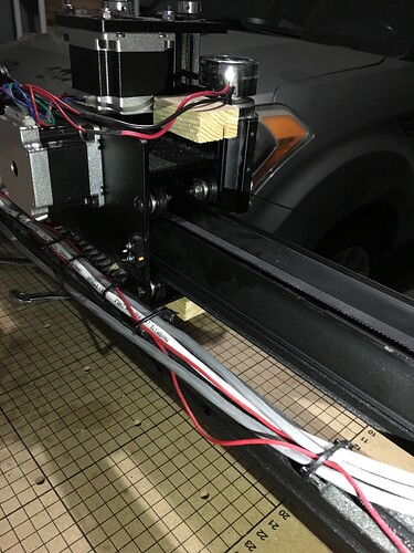

On my 100th plus carve and broke a belt
Not too happy about it. Haven’t changed anything or adjusted anything. Been running into more and more issues with my X-Carve. Looking for a different CNC honestly. I will be posting mine for sell if my luck or this machines shortcomings continue.
That looks more like it is probably due to the condition of the machine. I would look into dust collection. The V-Wheels are supposed to be riding on clean V-Rails and when there is a large enough chunk of something on the rails the machine might experience binding. The stepper motor, on the other hand, just keeps on chugging; it will cause the pulley to shed that belt very quickly.
{:0)
Brandon Parker
Judging by the photos of your machine, I wouldn’t be blaming the X-Carve !
