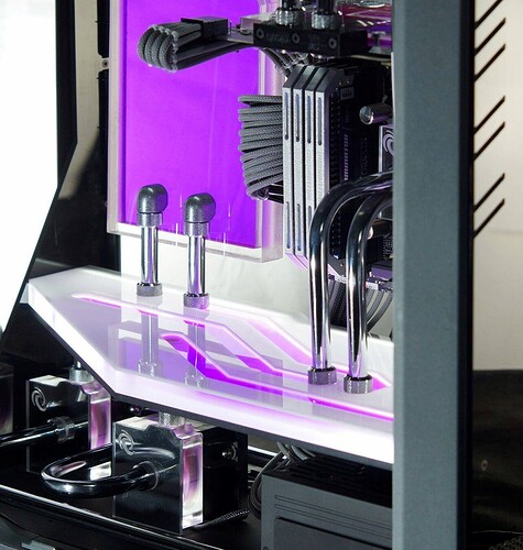

Effectively it is a 3 piece construction, with the center piece being the water channel begin and end points. Kinda like a circuit board, but with water.
that circuit is then sandwiched by clear acrylic, and then tapped on the appropriate side for the tube fittings.
Hope this helps,
-=CT

The uploads didn’t work, you need to wait until they’re fully uploaded and visible in the preview pane before posting. 😄
I think I can imagine what you’re describing, it it sounds very interesting. The engineer in me is already starting to come up with ways to shift and stop flows with built-in valves and such. Mind candy!
If a square cross-section for the flow channels is okay, you can easily use Easel with an imported SVG.

![](https://canada1.discourse-cdn.com/flex009/uploads/inventables/original/2X/5/5bb6695f036c9f878fa453f43f0dda9aef02a759.jpg)
 ![](https://canada1.discourse-cdn.com/flex009/uploads/inventables/original/2X/b/bb4941d8d37e0ca41d2e082462745456049601a5.jpg)
There we go…

So much more beautiful than I could have imagined… 😍
Easel’s a good way to go with that until you decide you want to get more complicated. Personally, I would draw up the pocket pattern in SketchUp (or some other CAD program) and import as an SVG, run it through [www.Makercam.com](http://www.Makercam.com) to make it play nicely with Easel, then import it into Easel.

In the high end computer modding space, where I dabble and participate in, work and evolution of water cooling is constantly evolving. It is nearly impossible for manufacturers to mass produce these kinds of things, because the internal dimensions of each computer case differ. And where one person wants to put reservoirs, pumps, radiators, is likely not where someone else wants to put them.
_So_… I wanted a better way for me to build and create my custom pieces.
Initially I was thinking a Glowforge, but I need the ability to cut or mark certain types of metal.
So, X-Carve it is. 🙂
This piece is not mine, it is simply an example of what I am wanting to do. And this tool will hopefully help me get there.
