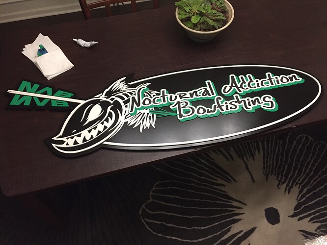

Well our Lowes doesn’t carry but thankfully Home Depot does $60 a sheet ALOT cheaper than the HDU material , Did you glue any of it together if so what did you use? and assuming you painted it what paint did you use? This is listed as PVC board so curious if you did anything different than what Plane Crazy did with the HDU material he used Rustoleum which is my preferred rattle can paint, I don’t like the Krylon paint at all.
I’m glad to hear you found it. Even the workers at my store weren’t aware of it when I asked. They had to look up the part number to find it. LOL.
My project ended up not requiring glue but I had planned on using the normal pvc bonding products made for pvc pipes. My understanding is that it actually chemically “melts” an outer layer of pvc so that the partner piece’s melted layer intermix when fitted and they become one piece after it cures. That being my understanding, I felt like those products would create the strongest bond. I’m sorry I can’t offer more than my thoughts on that. I never actually did a glue test.
My wife ended up painting and I think she used acrylics but we were in a rush at the time and just used what we had. If I were to do it again I would find a primer suitable for pvc before any final coats but what we used worked.

I recently saw this material used https://www.inventables.com/categories/materials/plastic/hdpe at a hotel on a sign that said “keep off the grass”
They used the green and white variety.
Thought that sign said Noctural Emission for a second when I first glanced.
Tripped and fell right in the gutter.
I’m curious how it will hold up to UV light outdoors. That has always been a problem for me on outdoor signs, especially black as it tends to chalk up.
I coated the whole thing with poly once it was done. I’s only been a few months, so not sure of the long term.
