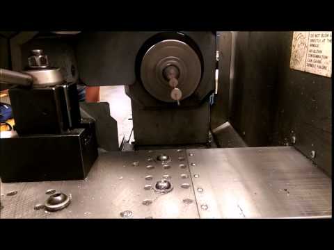

Critical speed was mentioned earlier in this thread, so let’s dive in a bit deeper.
Here’s a nice definition:
Critical speed is the first resonant frequency (speed) of the rotating shaft. Resonance in a rotating shaft can be catastrophic and even break the shaft.
Here’s a nice example:
