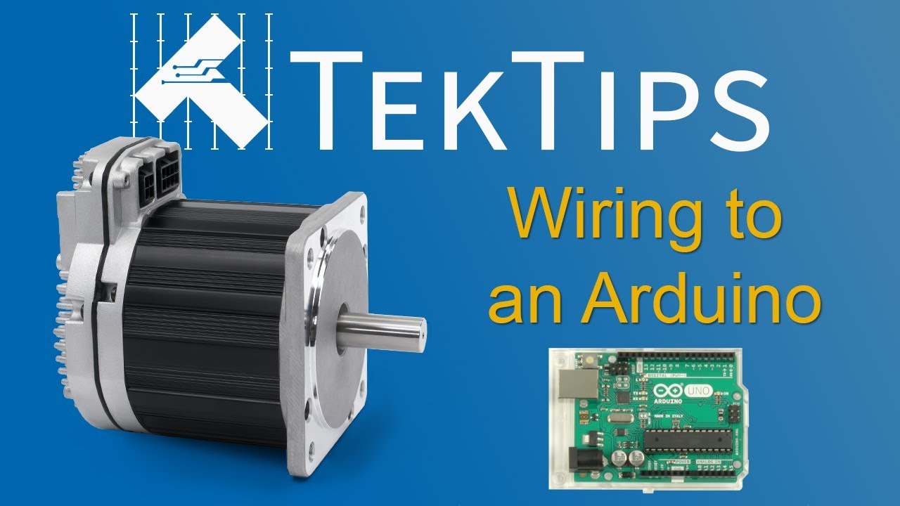

I wanted to share with those who are getting this upgrade to consider these motors. They are not cheap but are perfect for those wanting to upgrade to a more powerful motor. These are not Steppers but are way better. Watch their videos and see for yourself. Of course I am not suggesting you buy any but as an alternative to slow steppers these just may work better.
This link shows the SD series which is what you want for the Stepper functionality.
Here is a video where they show it hooking up to an arduino.
These should work with Easel and be a virtual replacement for the current stepper motors. They are high torque and very sturdy.
That’s a spooky coincidence. I ordered minifit jr & sabre connectors to build cables for these less than 30mins ago.
I have already switched to single Y transmission to be able to run autotuning when I receive them.
These look cool and would like to see if anyone else is successful in getting these to work on an XC.

They could work on an X-Carve but not out of the box. I can think of at least two areas you’d have to address via its software:
  • X-Carve’s (light) weight and (relatively low) rigidity. You’d have to set torque limits to avoid breaking belts and V-wheels. With leadscrews you have better chances.
  • There’s a great autotuning feature that takes care of all motor parameters. This plays well with one motor per axis. Having two motors on Y complicate this. You’d have to get creative to work around this and probably still have to guess some parameters.
