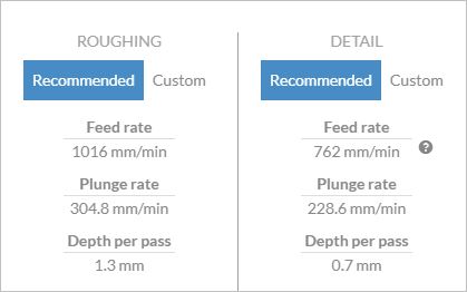

To start off. I have used my xcarve with great sucess, this is my first attempt using a piece of oak.
I am dong a vbit sign for my father using the 90degree .25 vbit that inventables sells. I have my dewalt router set to 1. But im concenred about the feed rate and plunge depth.
I am using vcarve desktop to setup my sign. I understand what feed rates and plunge rates are but i dont know how to set them in vcarve for Oak…or what would be the best speeds to use. If some one cold provide some help or even a screen shot of the tool setting for oak from vcarve would be awesome.

We don’t usually do signs, but we made this quick one in Easel a few months ago. For the roughing pass we used a 2-flute 1/8" upcut (eBay cheap). For the detail pass, we used a 60° V bit. Since Easel doesn’t have a pre-set for oak, we just used the default cut settings for hard maple, I think. If you have a very large project and want to reduce carve time, you could probably push the feedrate some, but these settings were perfectly fine:
![cutsettingsoaksign](https://community.inventables.com/images/transparent.png)
This is the finished project:

Kimberly - Thanks… I took a Chance and lowered my feed rates and crossed fingers… I think it came out awesome thanks for the Response
