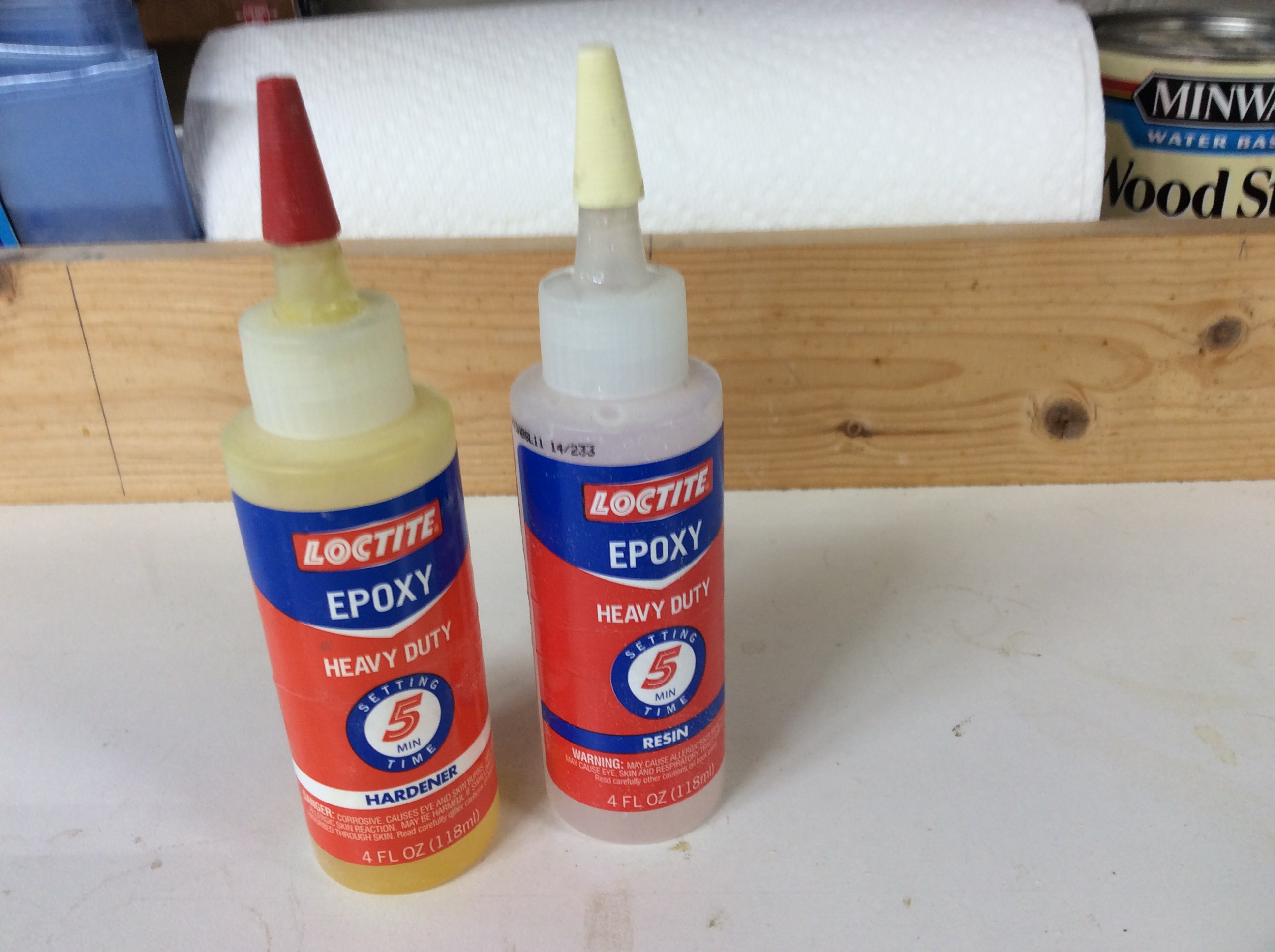

What was the brand of epoxy you used?
I got mine from Germany many years ago - Epoxy Resin L + Hardener L (40 min)
But most slow cure resins will do ![]()
This is the epoxy I used in the video. You do have to work quickly. A slow cure epoxy would give you much more time to get it poured and to remove the air bubbles.
To add to that - slow cure usually = thinner epoxy, high viscosity which prevent a lot of the air to get trapped in the first place. The air that do get mixed in rise faster.
One thing I want to add. You can add a couple drops of alcohol to then epoxy when mixing. This will thin the epoxy giving a slower cure time and allow you to move more of the bubbles to the surface

FYI when you pour the 5min epoxy you need to have it come out in a very thin pour. You will get less air bubbles. Some people will pour from a height of 1 and 1/2 feet so air bubbles will be at a minimum.
I also add a little alcohol to the mix
