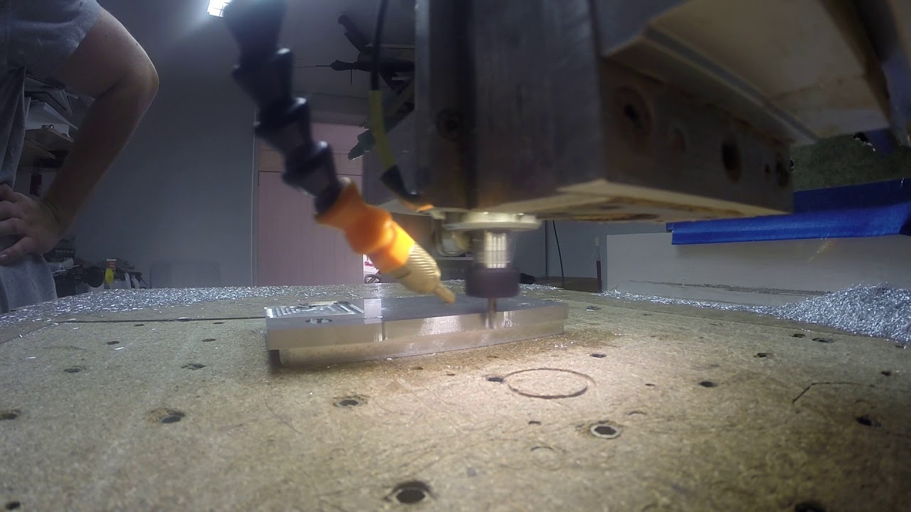

Pushing the limits for my machine, and a “chip restrainer” :slight_smile:
MMR=10,2ccm/min (initial path and 6,8ccm/min for the adaptive)
Can smell the heat of those big chips :slight_smile:
7022 aluminium used.

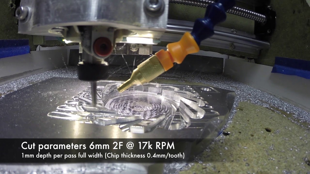

Another video showing my current project in the making, a miniature turbine for RC jets :wink:
I had to spend some time getting my machine fine-tuned as the tolerances are slim…
Also had some sudden connection issues that caused me some grief.
1360mm/min @ 17k
6mm 2F going 3mm deep per pass / 2,4mm stepover
Two parts are shown here, the diffusor and its cover plate.

I use 6mm 2F a bit and the cut parameters for me is:
RPM 17k
Feed rate 1360mm/min (680mm/min per tooth)
Machine rigidity will determine how deep per pass, start shallow and increase this value once confidence is growing.
Try 0.02" DoC to start with
The bit specs that follow my 6mm bits suggest Vc=500m/min and chip load 0.05mm/tooth which is less than Destiny.
Hope that helps :slight_smile:

Taking this one step further, the feed rate * DoC * WoC = MRR and this is ultimately the threshold for any given CNC.
Fr * WoC * DoC = MRR, cubic cm per minute
4000mm * 0.1mm * 8mm = 3,2ccm/minute
1360mm * 2.4mm * 1mm = 3,2ccm/minute
With my setup I can push:
1360mm * 6mm * 2mm = 8.1ccm/minute (tested)
My rapids are 4000mm/min and torque at speed is low so I can not push my MRR up at this feed rate.
