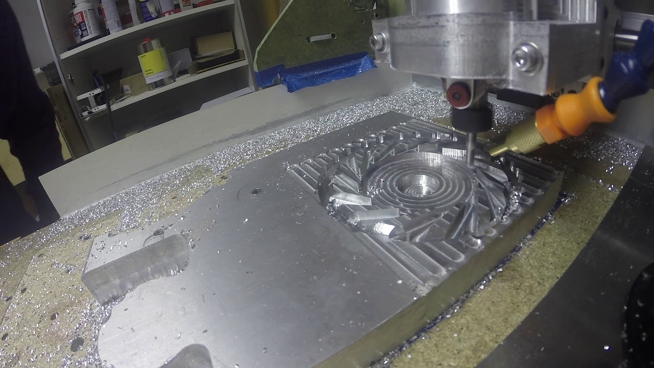

The Makita mount was completed today in 25mm Alu, 900mm/min @ 1mm DoC with a 6mm end mill. Still need to drill out mounting holes and tap them before I can assemble/square up the new Z-slider.

Update - I finished assembling the new Z and performed a quick test cut. The sound of the router is very different, more “connected” to the machine and less rattle/vibration noise. Needed to recalibrate steps for Z and is is pretty close to spec.
The test carve was two circles with 12mm diameter / 2mm depth and 20mm dia with 1mm depth + a rectangle of 50x30mm at 0.5mm depth in aluminium. RPM 18k with 6mm 1F running at 900mm/min and 0,5mm DoC.
I have a manual calliper and the circles measure about 11,8 and 19,8mm, and the rectangle about 0.2mm undersized. I have not measured the bit actual diameter but my machine has some flex in X/Y.
As far as the Z goes - it is FIRM! I manually reset Z to the top surface of the alu, placed a 8kg load on top of the Makita and jogged Z up 0.03mm before it cleared again. I used a voltmeter set to continuity mode.

BTW - I haven’t tested to accuracy yet, but I expect do take a hit but 2mm DoC with 6mm WoC went without a hitch :slight_smile: 900mm/min (chip thickness 0.54mm and MRR=10cm^3)
