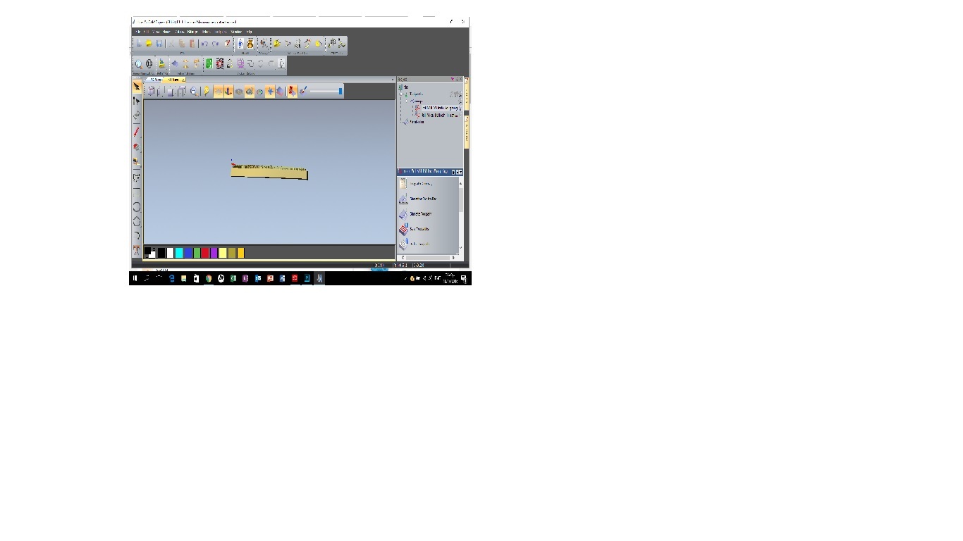

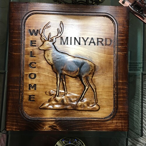

you know we have rough and finish ,first i work with rough ,this is the first time i use whole model and select all the surface to carve because I want to know the line disappear in my model, My idea is the line happened because the bit hit the left side of the edge when start to do the finishing as you see in my photos .
so I want to carve all the surface that means the z zero will change because the rough take about 0.25 in deep in my model.
now i have two Z zero one at the point when start roughing , second when ending roughing
which i will use ???
that is the question

As you see my Zero X,Y,Z are on my board ,after did the relief the Zero stand up on my board , so if I want to do the finishing I have to set the Zero over the board, like the photo I send.
can I do the rough only then I do the finishing in separate calculate .
