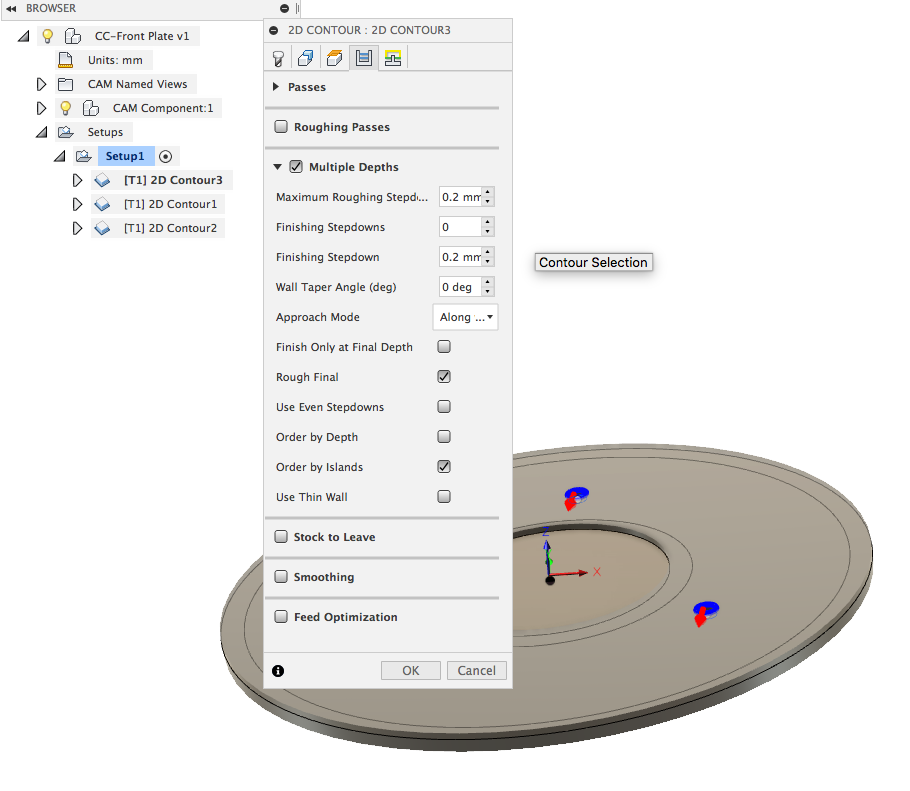

Thanks. I tried the contour, but it only creates a path for the bottom edge which I imagine is way too aggressive of a cut.
You can enable Multiple Depths for Z with Contour in order to keep the depth per pass within comfort.
Maximum Roughing Step down value in the incremental Z step performed.
This is for stainless steel so I go light, 0.2mm/pass
