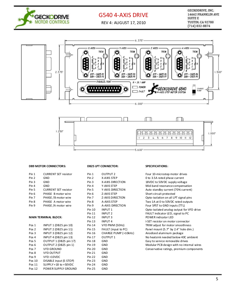

So how many actual connections from the arduino to the Gecko?
Is there a diagram somewhere?
Thanks for the info.
Looks like seven plus ground.
No arduino, no gshield. No serial port. Just computer to Gecko via parallel port. You can put a parallel port card into your computer or use its existing parallel port if it is an old computer.

Lower seven pins on the right and ground.
They’re not. It’s a parallel port and you use a program like LinuxCNC or Mach3/4 to control the G540 and other signals through the parallel port.

A few details about my X-Carve set-up with a G540.
It has a 48V power supply (50V is the maximum that the G540 will support) and is connected to an (old) HP computer via a parallel port. I use Linuxcnc as the control software but Mach 3 will do if you prefer a Windows based solution.
There’s no tuning to select the correct current for the motors, that’s done via a single, fixed value resistor for each driver. The only adjustment is for mid-band resonance which shows up as a ‘growling’ at low speeds. With the motors running at low speed, you adjust a pot until the noise goes away, no guesswork or measurement.
It runs very well, quiet, fast - much faster than the X-Carve is mechanically capable of.
As far as running the G540 from Arduino/grbl, all you need, as suggested previouasly, it to connect the right pins from the Aduino to the Gecko.
I’m currently building a very simple interface box to do this, see this thread. Running the X-Carve via grbl with a Gecko G540 controller
Not tested as yet, still working on a new spoil board setup.
EDIT: Just saw @LarryM’s latest post with the parallel port wiring. Here’s the connections the G540 expects. Manual available here.

Can you tell me how many volts a Nema23 uses?
You need a parallel port, not serial.
Parallel ports are getting rare on curent machines but you can buy an add on port for a few $$.
Mach 3 does support USB connected controllers such as the Smoothstepper but this is an extra $200 or so. Not supported by Linuxcnc.
Easiest way to use the G540 is via grbl is a simple interface as I’ve described.
The primary concern for stepper motors is current. Since the voltage is turned on and off rapidly to limit the current through the stepper motor windings you can operate a stepper motor over a wide range of voltages.
What you need to know is the current limit for the stepper motor and make sure that you have your stepper motor driver set up to provide the correct current.
The NEMA 23s that Inventables sells can work up to 2.8 amps per phase.

Motors are rated more by current than volts. The main thing is to make sure that the controlller you use (gshield, G540, etc) can provide the right current.
The current rating is listed on the motor. The maximum voltage that you use with a stepper is a lot higher than the voltage listed on the motor spec. The operating voltage is anywhere from 4 to 20 times the listed voltage.

The power supply needs to provide:
  1. the highest voltage your motors/controller can use
  2. enough current to drive all the motors
