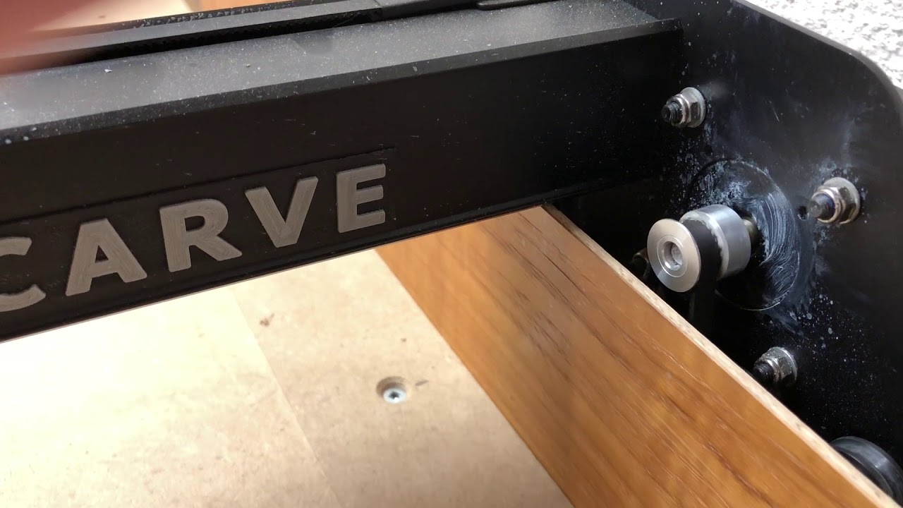

Also see video and hear the noise I’m talking about here:

The video makes it sound kinda like a repetitive clunking sound. And is it just me or does the pulley look slightly out of round?

The clicking noise sounded to me like tight belts / belt teeth slipping into place.
FWIW
I’m pretty sure that that is not a motor noise. I too, would look to the belts as the most likely culprit. Not as easy to determine why the belt would do that.
Take the belt off and re-run your test to see if the noise goes away.
Look at the side of the belt with the protrusions to determine if you can spot any damage. Look for a belt that runs up against the side of the pulley.

I’ll try disconnecting the belts tomorrow, I’ll do the X axis and see if the motor makes any noise. Mind you, I never heard noise like this when using the GShield… Also the machine is missing steps on both X and Y, but if the belts are causing the noise that maybe unrelated.
