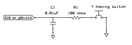

Hey. Do you have a wiring diagram for the limit switch filters? Thanks @PhilJohnson
This is the filter setup for the X-controller. It works quite well and gives a faster response time. I recommend using this one.
Repeat for the other axes with the appropriate changes. Also, put one on the Probe input.
Those capacitors are way too large. I used to use 0.47 uF capacitors. Yours are 100 times the value that I used to use.
I’ll try to explain the schematic.
A wire comes from a gShield pin (D10 for Y axis) that wire hooks to one lead from the 0.01 uF capacitor and also to one lead of the 100 ohm resistor.
The other lead from the capacitor is hooked to ground.
The other lead of the resistor is hooked to the wire that goes to your homing switch Normally Open connector.
The Common connector from the homing switch is connected to ground.
Ordered the resistors and .47 and .01 uf.
If you use the circuit with the 0.01 uF cap you don’t need the 0.47 uF caps.

Can you give any insight into those RC filter values (100Ω and .01uF)? Why is the frequency so high?
The filter is to eliminate the electrical noise, not the true signal. Valid signals are low frequency. Noise is high frequency. You want the filter to eliminate high frequency signals.
It’s a low pass filter.
You could raise the value of the capacitor to tighten it up a bit, but that would increase response time for the valid signals
