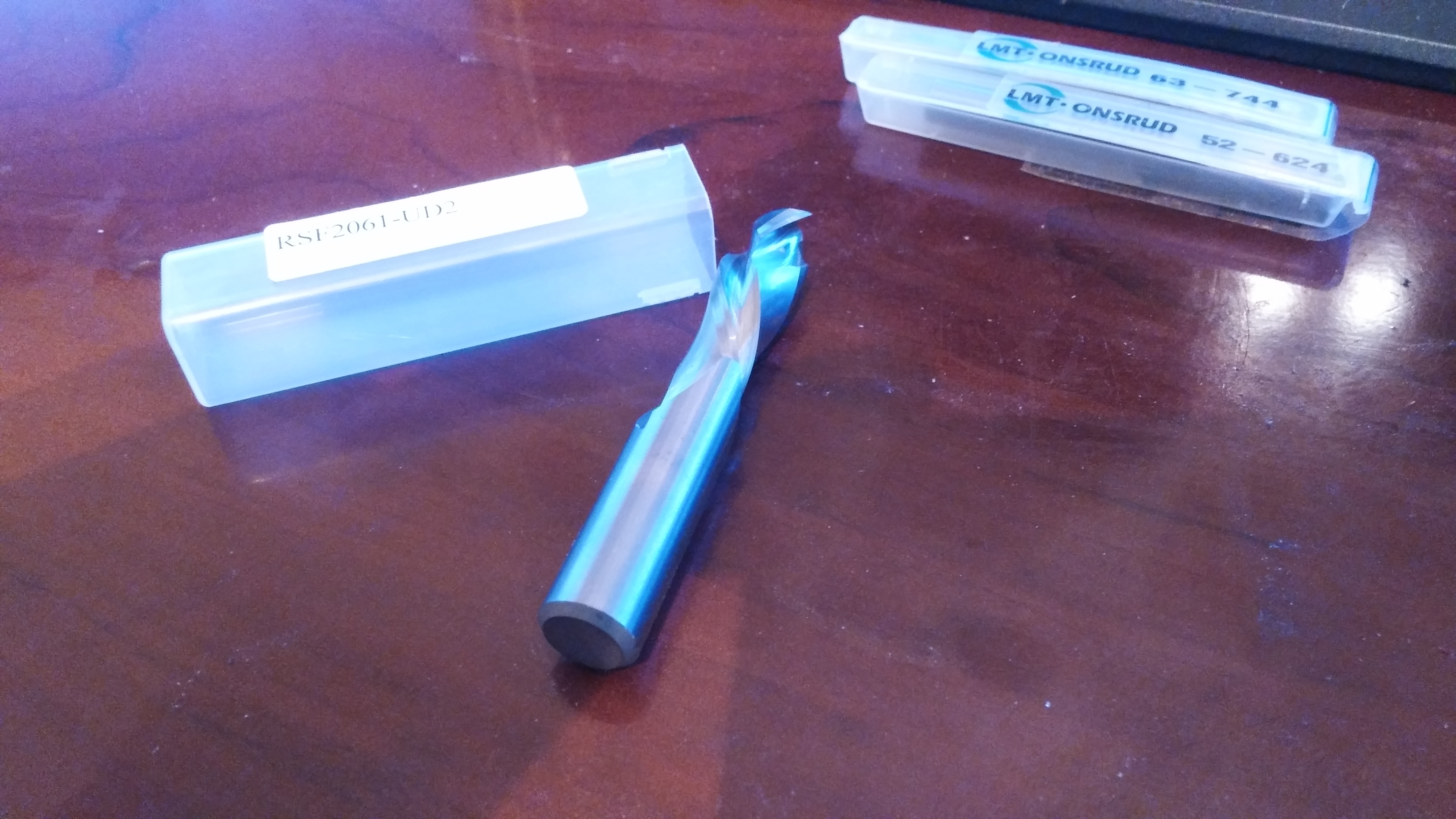

hey allen do they have the offical LMT Onsrud logo imprinted on the end mill?
They are stamped, I don’t recall if there was a logo or not, I can check when I get home.
Yeah man could you please send me a picture of the end mill with all the lettering on it
thanks
They are stamped with
ONSRUD
40-024
5/16
c be
There is no logo, but it looks exactly like the catalog picture.  I have no idea what the c be code means.
But I checked my other Osnrud tools and none of them had a logo either.
Hey thanks for the picture I am just curious because to my (limited) knowledge all onsrud tools have there official logo stamped on them
I wonder if they are not a copy cat endmill (aka knockoff) I am checking with my personal tool rep to find out if maybe they are an older model of endmill before they started to stamp them
I just wonder about them being a knock off due to the price
*** Don’t get me wrong I myself ordered a set and I in no way want the seller of these end mills to catch any flac if they are non-legitimate endmills I am just curious**
Reason i am curious is the require chip load for the tool to perform properly and get the required life out of it. If the grind is not exactly the same as the Onsrud grind then the chip load will be different and you could wear out the tool faster than expected.
but for 25.00 for 5 who cares if you mess a few up trying to dial them in lol
There could be a 1000 reasons as to why these end mills are being sold at a deeply discounted price so I am not to judge I am just curious if they are legit Onsrud
Okay I just got off the phone with my Onsrud rep and this is what he told me:
They are Legit Onsrud products
They where made around 1986 (that is what the cbe is for)
they were made on non cnc equipment back in the day a cost about 8.00 each brand new
They were made for pin routers for the Aerospace Industry to cut aluminum but will work just fine in natural woods
Seeing that they are coming from the northwest his best guess is that they are old stock from the Boeing Facility that is up there
The reason the price on the website is so high is because they are fresh grinds and made on a cnc machine not old stock
Some pretty cool history I told him the price and actually he said that was kinda expensive for 5 mills that are that old he has seen them go for 1.00 each

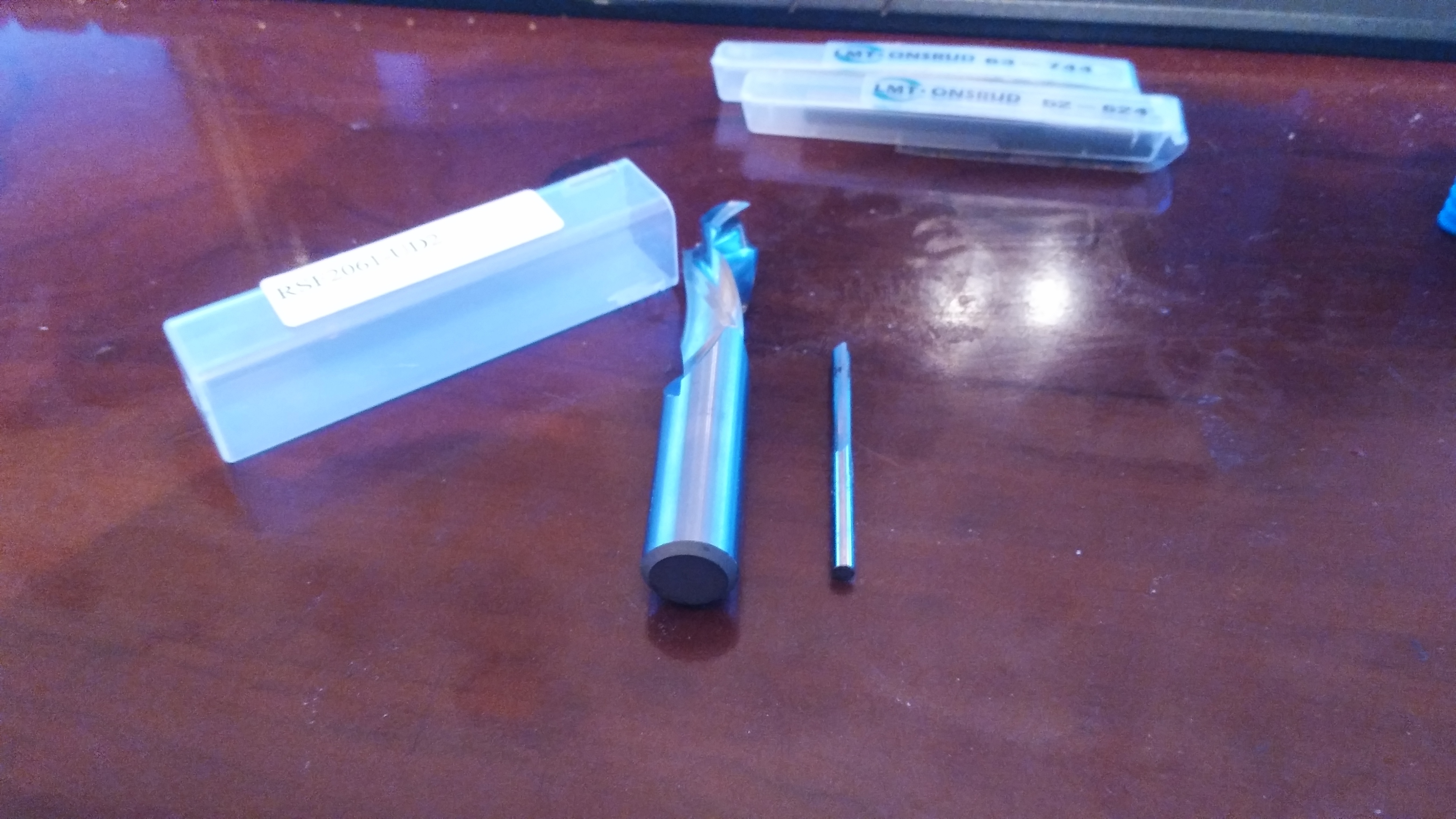

Check it out I scored another old stock bit today originally 100+ bucks and I got it for 45
.5" compression spiral solid carbide USA Made FS Tool
Let me know if anyone wants one I can get a bunch!!
I put a .125" tool in there for size comparison lol
