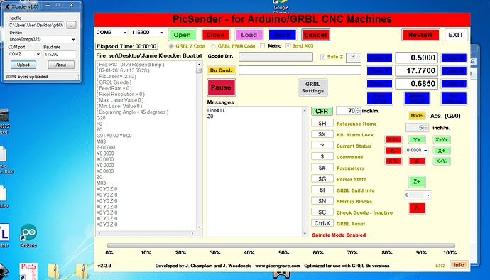

So i downloaded the new firmware and this is what came up
…is there anything else i need to do with it?First connect to the Com Port using PicSender. After connecting, select the GRBL Settings button. Copy & Paste the grbl settings into a text file. The curser will be a line through a circle, but you can still highlight them with a left click & drag to copy them all. You will need this settings when changing to the J-Tech firmware.
Close the Com Port in PicSender. You will then need X-Loader to flash the new firmware to the UNO.

I deelpy apologize for my inability to make sense of this, but i checked my com port and also the baud rate and they are identical…why wont it connect.
Good question. Try closing PicSender and reboot your PC and try to connect again.
well that worked thank you! noe on to my next question(s):

2). Since I downloaded the new Arduino fireware my laser will not turn on?
3). Now that the port was closed and the new flash was uploaded thru the xpadder how do i run the program?
PicLaser will give you the engraving size. The J-Tech grbl firmware uses S0-S255 commands to vary the laser power, not Z commands. You also have the feedrate set to 0.
First you should set the Gcode Dir. location. Then select the yellow GRBL button to make the grbl changes for your machine. Did you save them to a text file? Here are some other changes that needs to be made.
That make sense now so because the z0 commands are in there the laser is not activating… Also I ell mess around with it a little more to see how much further I can get. This is quite the learning curve
