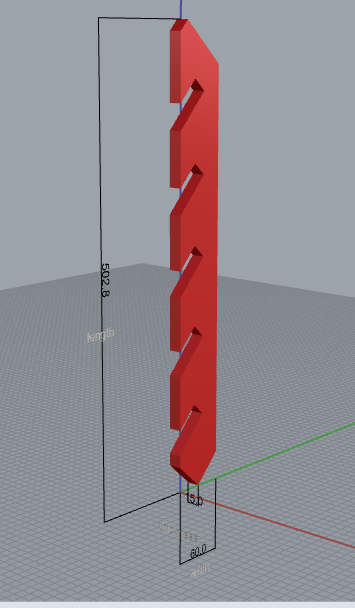

Ladder with these specifications
Good afternoon creative community.
I was recently asked for a ladder with these specifications, but I’m not an Easel pro.
I needed your help please. It will possibly be 9 millimeters thick.
It will be used to place decorative candles.
Yours sincerely
Fuinhas

The overall 3 dimensions which are not placed correctly like they would normally be on a technical drawing are not much of a help at this point. Are the steps joined by a lap joint to the angular ladder?

All these little surfaces really need some measurements to get what you want. This is just a rough idea with some made up numbers to fit into your 2 dimensions.
Good morning Martin! I am using measurements in millimeters. The measurement is exactly equal to the angle from front to back, 38.5 centimeters. The thickness can be between 15 millimeters and 9 millimeters, I intend to use some scraps of marine plywood. Thank you very much for your help Martin.
OK…let’s try this part by part. These dimensions are in mm. Is the overall shape what you want? If not, provide the thickness, width, and length of this part that you want it made from.
Hi Martin! Yes, I want the general shape or else the thickness could be 9 millimeters, the steps of the stairs and the sides maybe 15 millimeters.
See if this opens up for you. You can manipulate it as you see fit for your project.
Yes, I can open it on Easel. Thank you very much Martin :hugs:. Greetings from Portugal :portugal:
