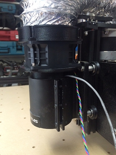

Yet another JTech 2.8w mount for the X-Carve. Needed to vent the smoke / cool the laser but I didn’t want to use a vac. Still a work in progress but it should work fine with a stronger fan. This mount slides into the DeWalt spindle carriage. Might work on a smaller mount for the DC spindle carriage once I move the laser to the smaller machine.
EDIT: Just got a crazy strong fan. ~130cfm noisy, fast and truly amazing. Delta PFC0812DE
Pics of the latest prototype with the fan installed. Have not mounted it on the machine yet. Will hopefully get to it this weekend.
Also thinking about building a mount for the electronics. For now I wont worry about it.

Finally got to test fit the fixture on the X-Carve. So far I’m happy with the results. Im printing the official JTech laser driver mounts to see how it will work with the hose. Not sure yet how the hose will work. Might have to suspend it above or tie it down to the cable chain mid-way.
I’m curious to see if sucking the smoke by the laser’s lens will contaminate it with soot.
Im sure it will over time… but this fan really sucks so the smoke doesn’t linger around much. Using the Laser Etch software in demo mode. Assuming that’s why only part of the image is generated in GCode.
Ill upload a video soon.
My Lifeproof phone case seems to haze the video a bit… but you can get the idea of the fan noise and smoke evacuation. Video Link
