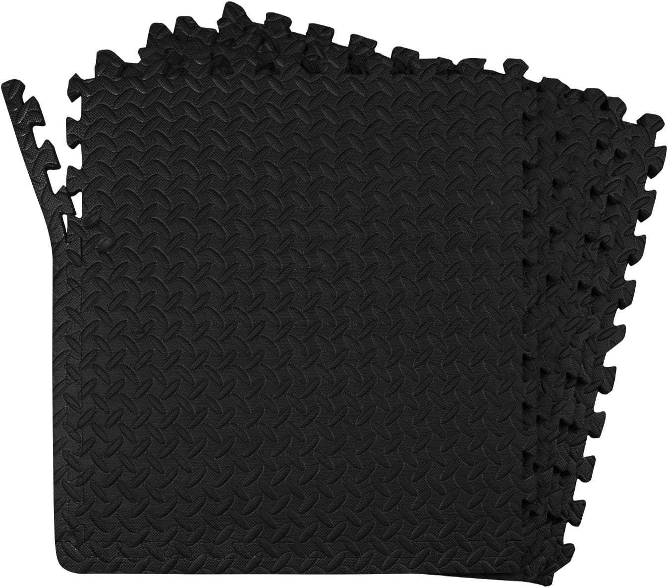

Today I decided to put some some thin (0.5") padding under the X-Carve, maybe cut down on a little vibration. When I moved the X-Carve I noticed I had almost 2 years worth of sawdust that had worked its way through the holes in the wasteboard. I clean the X-Carve after every carve, but the amount of sawdust underneath was insane. It was from everything I had cut from wood to corian to aluminum…I didn’t take any pictures as I just vacuumed it all up, but I was surprised by how much was there.
I used this under the machine…will it help? Who knows, but it looks good ![]()
I bought these anti vibe pads off Amazon… they seem to work well… better than just having the machine sit on the wood table.
4 Pack of Anti Vibration Pads 4" x 4" x 7/8" All Purpose Super Duty Blue Composite foam Vibration isolation pads https://www.amazon.com/dp/B004HGEPB8/ref=cm_sw_r_cp_api_1GH6yb78W20E4
I still have a bit of vibration that I believe is being introduced by the laser mount. I am going to design a new mount that has more mount points. I think having the two screws on the left side and pressure holding on the right is the problem. I’ll post what I come up with.

Did yours have an awful smell to them? I was also looking at these;
https://www.amazon.com/Pack-Anti-Vibration-Rubber-isolation/dp/B001THXRP8/ref=wl_mb_wl_huc_mrai_2_dp
Cork helps allow additional dipole cancellation and should work better than foam.
For what I am doing with the laser, depth is not really something I take into consideration. On full power, an etch into the bamboo cutting boards is about half a millimeter. Softer woods I guess you can vary the intensity to vary the depth, not something I have done.
And no smell of the pads that I noticed…they sat in the garage for a week before I messed with them. As far as the vibration dampening of the pads, the vibration I have is only noticeable with the laser as it is much more sensitive than plowing a bit through wood
