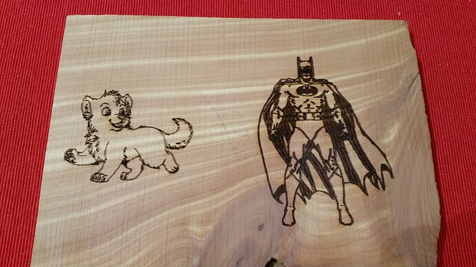

Well, here is the latest upgrade I am working on.
I bought the 3.8 watt laser from J-Tech Photonics ( https://jtechphotonics.com/ ).
I printed the mount posted by @JasonWest on this thread: Jtech laser mount - #8 by JasonWest
Everything is on the mount and it comes off of the system with 2 screws attached to the left side of the Router mount. Very easy to put on and remove. I still need to clean up the wires (mostly shorten as they are way too long).
I added a bit of complexity to the connection of the laser by using a much more powerful power supply to run my system. I have a 48v 12.5 Amp power supply running everything, so I have to pull out the old Inventables powersupply and use that one in conjunction with my Gecko G540 supply. I will wire up the power supply, and configure Mach 3 this weekend.
One thing to note about J-Tech Photonics…Jay Johnson at J-Tech has been a huge help in getting me to understand how things get connected. Every question I sent was responded to very quickly. Great service @JTechPhotonics!
More to follow…

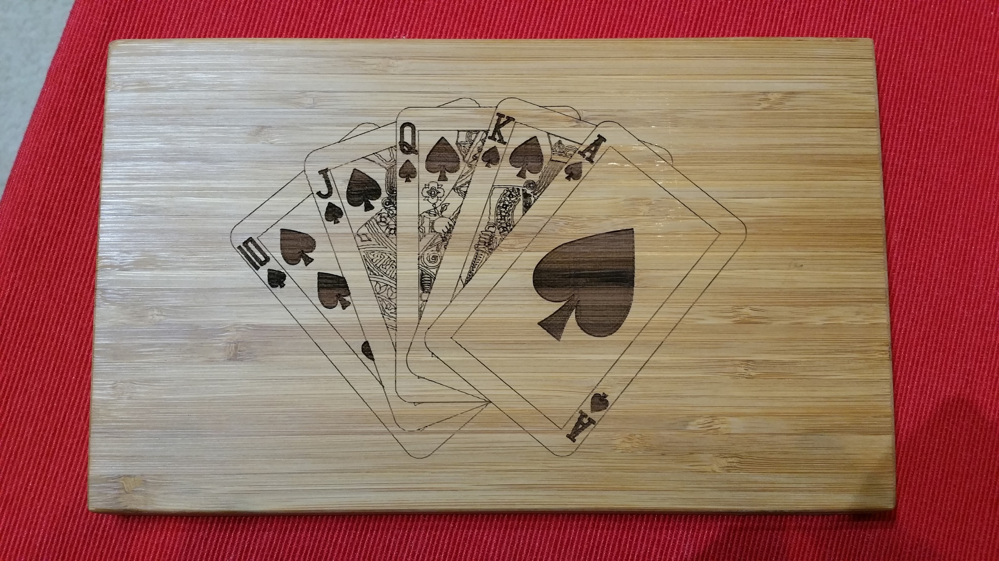

Everything is wired up and I did a couple of tests. I will go through the focusing process and try the cuts again.
These are done at 75 IPM at 2" from the workpiece.
Two more test pieces…
Focused the laser one inch from the material, much cleaner lines, nice and crisp. The etching should be a bit darker, but I am pleased with the results. I think once I oil the board the image will really stand out.
