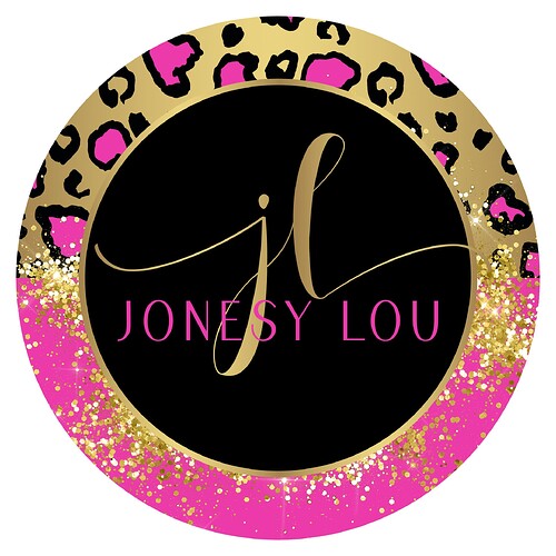

In over my head?
This is my most detailed undertaking to date, and I’m stuck, much too much detail for my limited experience. Using image trace with no success, any help, suggestions, and comments are greatly appreciated!
What exactly do you want to do with that bottom part, which is where I am assuming you are failing? That’s not particularly milling friendly (I supposed you could spot drill those dots but it wouldn’t look very good I’m betting) Maybe change the bottom part to have stars or something that are more millable, or you could do some sort of depth by color (like the white dots are 1/4" the light gray .2" tall and maybe the dark gray .15" off the base height?
