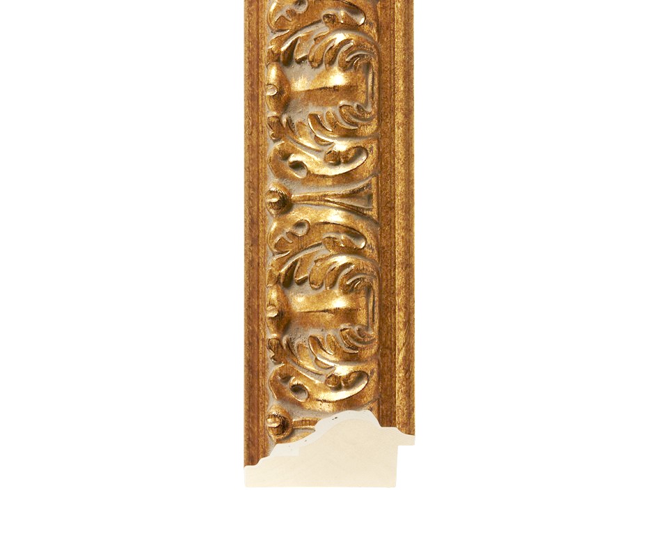

Hello i have the same question as WokinWoods, i think Picengravertoo gets the point of what we need to learn.
In short words, as example, how can we do, as beginners, easy and simple, this classic picture frame, how can we turn it to grayscale etc. ready for carving ?
