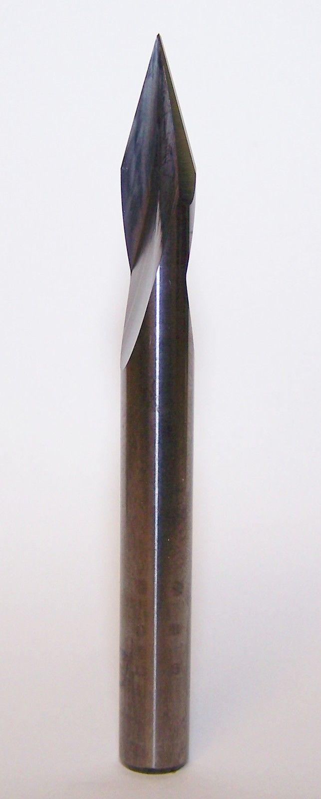

Just bought 5 of these bad boys for 60$ Decided to upgrade to the 1/4" instead of the .125" Hoping that solves my jaged edge issue on my acrylic glass. The 90IPM seems to vibrate like crazy. I seem to be getting lots of sales for LED Signs. So I’m also considering setting up some sort of compressed air setup to cool the bit.
Another way to cool the bit is to make a tank that will hold water and carve the acrylic submerged :slight_smile:

certainely (5) 30 degree angle x1/4" carbide bits engraving and scoring tools 2002-2500.030 | eBay
I’ll see if I can find them on amazon.ca. Have you ever found engraving bits like those in a 1/4" shank? That’s the main reason I bought the ones above, kind of sucks I just spent 60$ and now I find out they won’t be the greatest :frowning:
I’ve spent quite a bit of time on acrylic threads in this forum, all just suggest a 20 or 30 degree engraving bit. So I figured when the listing said 30 degree engraving and scoring bit I figured great this should work no problem, and even better it has the 1/4" shank. Never seen the flat tip suggestion, not saying it wasn’t mentioned,

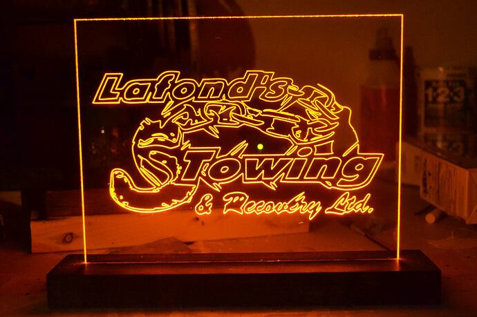

Haven’t been on the forums in a while! Been super busy with a new venture I am working on and these signs have kept me real busy as well. I have probably sold about 70-80 signs now. Here is one I did for a local towing company. Oh and I finally got a DSLR Camera :stuck_out_tongue:

Signs are looking great! I cant wait to get a machine and start making stuff.

@RyanBallard thanks for the kind words! I’m using new bits, and can’t seem to keep the tip from breaking -.-
ill have to try those and hope they hold up. I’m on my 4th bit.
