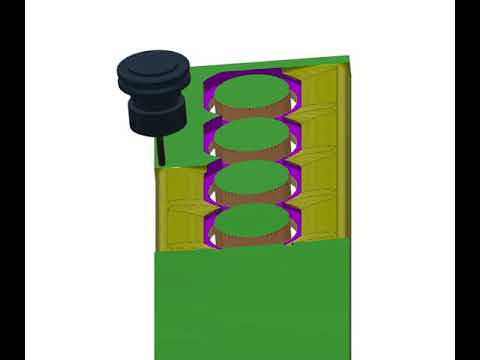

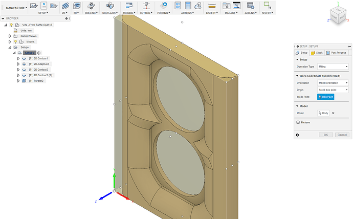

After a couple of weeks with a lot of travel I am back at it. Redesigned my speaker array front baffle and last night prepared the gcode files.
It will be my largest carve to date, spanning 2100mm in length and represent about 3hrs of carve time per baffle. The total length of the carve is divided into 6 sub-carves, each using two tools for the job. 6mm flat endmill for roughing, contour cuts etc (10min) and a 6mm ballnose for curvature (20mins)
If I am lucky (:crossed_fingers:) I might get to do the first carve during this weekend. Due to size of material and length of carve I need to temporarely move my CNC to either outside in the garden or into the garage :scream:
Fusion360 CAM simulation:

  • First operation, doing the pilot and guide hole with 6mm flat tool. CC spacing is 4x84mm (20s)
  • Second operation, machining the driver openings and mounting flange with 6mm flat tool (10min)
  • Third operation, contouring the waveguide surface with 6mm ball tool (20min)
I could do finer contouring but that = more machine time. Earlier tests show that the visible contouring lines quickly dissapear with light sanding in preparation of finishing. I will seal the MDF with epoxy resin which will serve as the primer/base coat.

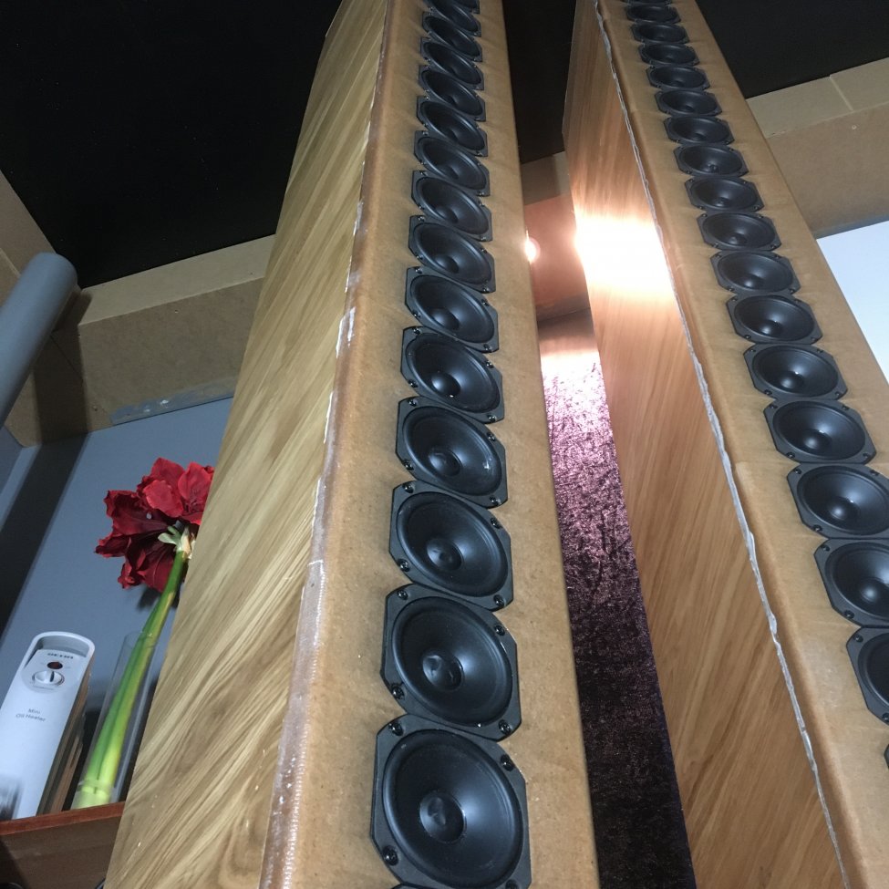

The contour carving of both baffles came out great and have been primed with 2 coats of epoxy. They will later be prepped for paint but for the time being they are as seen here :slight_smile:
Some glue residue on the corners are showing but will be removed when I prep them for paint.
To date my largest CNC project :slight_smile:
(210cm tall)
