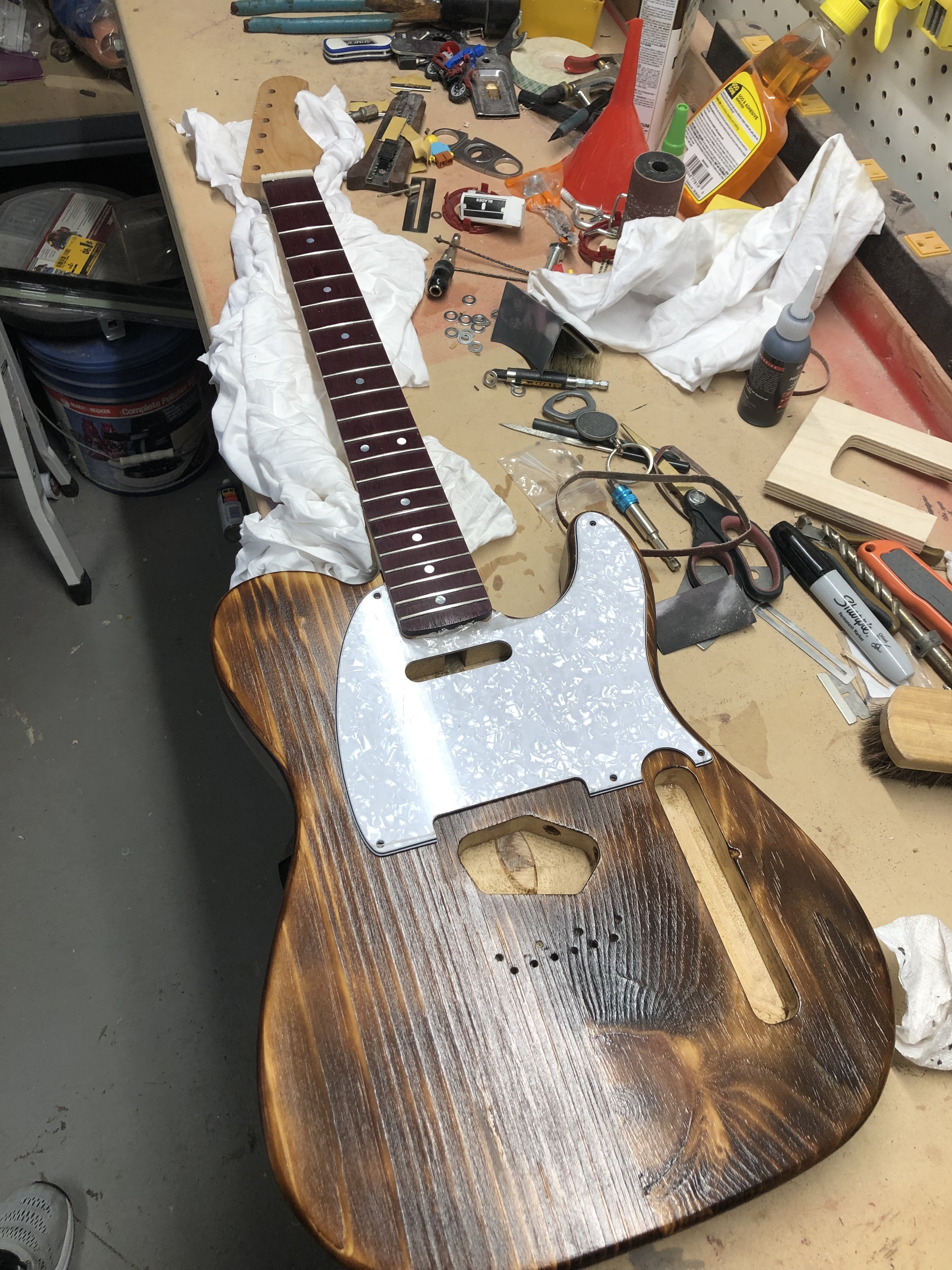

That’s a beauty, Bill! I ā€œassumeā€ you did that on the x-carve. What kind of time did it take? I’d like to see that finished.
@ToddSmeester It doesn’t take long for the routing on the XC, I think it took about an hour if I remember correctly. It was going to be a BBender (Tele Tramp stamp) but I boogered up the position for that route and had to plug it. So then I decided to try a few things and this is how it turned out
I see you have white, and black scroll designs. Are those just carved into the wood and painted, or are they some kind of inlay material? Looks really nice Bill. Thanks for the view.
The black is done with the laser and the white was v-carved and filled with epoxy.
