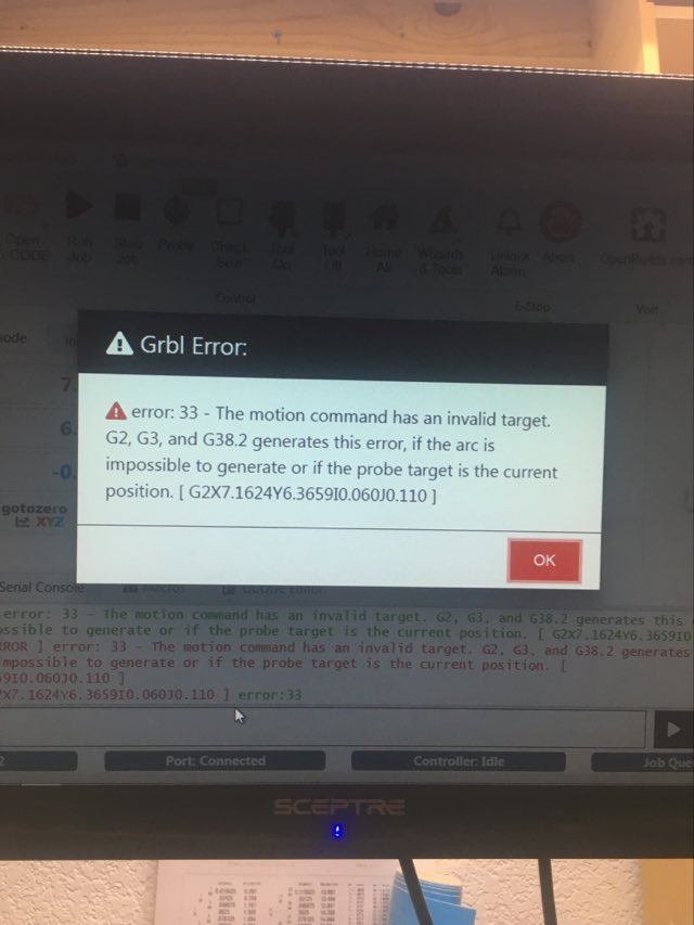

![GRBL error](https://canada1.discourse-cdn.com/flex009/uploads/inventables/original/3X/4/c/4cbf3e055ca1886b5ddc26557d5b4c6e1a354ec3.jpeg)
Can anybody help?
Carve stoped on two different files.

> [@JuanASierra](#):
> Can anybody help?
Yes, but I need to know what software you’re using to generate the gcode. This is most likely a post processing issue with the arc calculation precision. If available, use the mm post processor.

V-Carve Pro

I had problems after the last update on V-Carve Pro, the post-processor was giving problems, I got in touch with Vectric and they gave me a link to download a different post-processor, and everything was good after that

> [@JuanASierra](#):
> V-Carve Pro
Use the metric post processor, use your old post processor (with no arcs), use one of [these](https://github.com/neilferreri/V-Carve-PPs/tree/master/GRBL%20Toolchange), or track down the post that @PatrickDunne is referring to.
