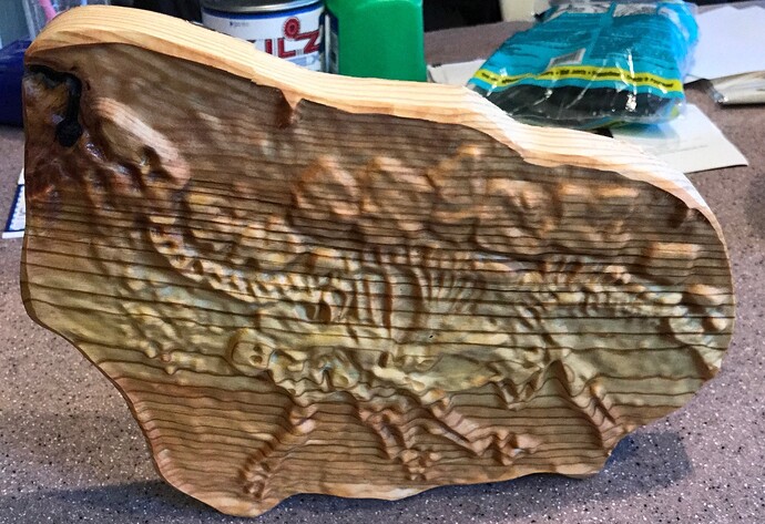

cheap little 30 degree engraving bit
It is about 14x9.

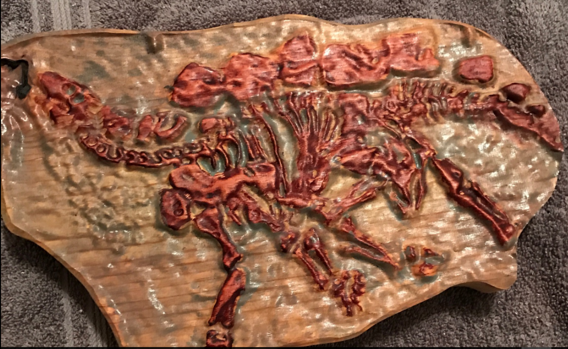

Here it is fresh off the table. This is cut into an old piece of pine to see how it would come out.
Has anyone used Rustoleum stone texture paint? Would it completly obscure all the detail?
https://www.rustoleum.com/product-catalog/consumer-brands/american-accents/stone-spray

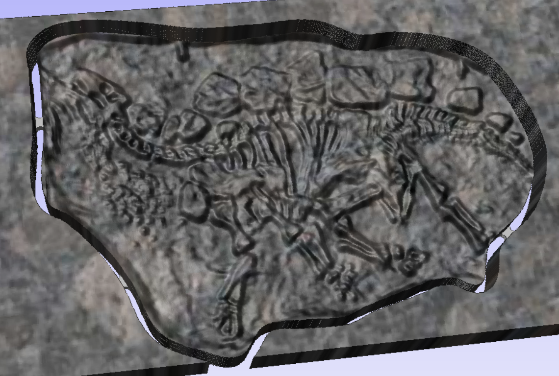

this is frustrating to see all this. i want to make a damn trilobite, but gave up on getting the STL to work in fusion. came close, but its beyond my abilities.
ive tried, no luck. im still pretty green on the computer part of all this. ill work on it again down
the line. i had the triangles down, and converted to polygons, but it still didnt like it, just cant get the tool paths
ill work on some screenshots, but i kinda started this thread…ha
phil!!! i saw your post on the pumpkin post. i can get the tool paths to work now!!!
yup. it will let me do the STL mesh of triangles, but not the quads…ha. next hurdle will be seeing if my crappy home computer will be able to handle the workload…its a struggle

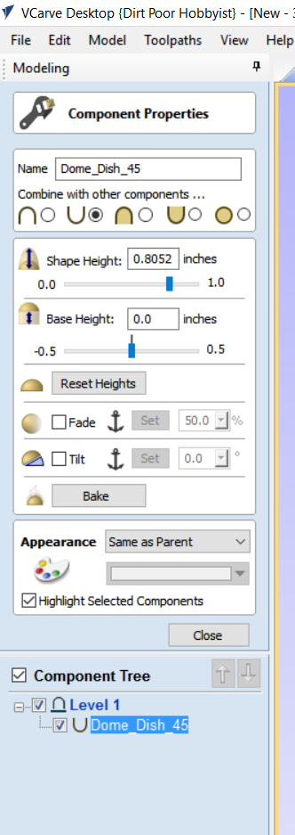

I love how it handles the vectors where you can make a job that is 2 parts.
One vbit and another is straight end mill in just one setting. It separates the passes for you.
