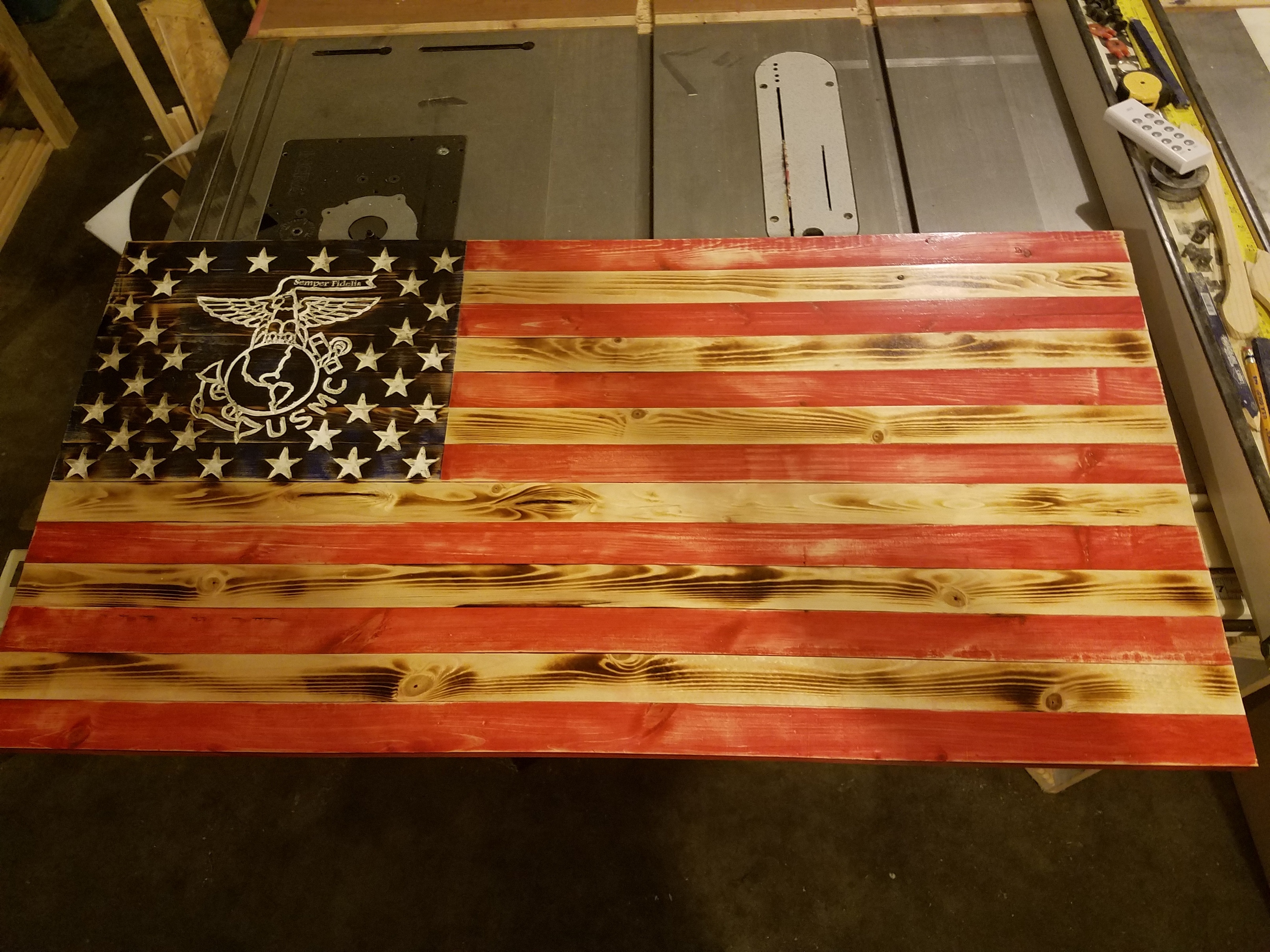

This one did not turn out the way i wanted. I had to carve the stars 3 times wich made them larger then designed.
Not my best work but then again its hard for someone to complain about a free flag.

Vet nice work! Looks like I will need to step my game up.
Are you using a thin plywood to back these?
I use 1x2’s and only carve 0.04" down. Plenty of stock left and didn’t see a need for a backer.

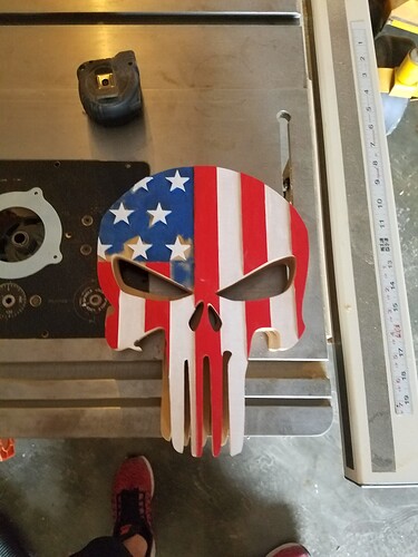

Here are a few Punisher Skulls I did with flags on them. Love the way they turned out!
I’ve had a few requests recently for the skulls like that, just haven’t got to them yet. Those look great man!
Those look great.
What material are those? How large are they?
They are made out of 1/2" MDF and 12" tall
Try this link: Easel - Punisher Flag
Just make sure to delete the black outline border cut before you carve. Then add them back in and delete the flag portion to cut them free.
@JamesPowell You need to change it to public
Were you not able to get it from the link?
Try this: Log In | Inventables
Ah cool. So you are doing it as a 2 stage carve. On yours what bits are you using?
On this one you can get away with using a 1/8" bit for the entire piece.
