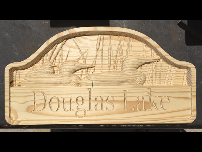

If you only do the finish maching toolpath w/ 1/8" and not a rouging + finish, you will be cutting 0.5 and 0.7 into the material with the one path.
Watch the status bar at the bottom when the mouse moves over the cut model. It shows the Z depth from the surface of the material.
You need to use 1/8 for both roughing (which takes layers out at the step-down) and also a second finish toolpath.
That being said. I really don’t recommend using the 3d roughing and finishing toolpaths for the bevels on the pockets…
Finishing the outside with a hand-router is a more time efficient option. https://www.amazon.com/Yonico-13903-Degree-Chamfer-Edging/dp/B00TQ4X7GU
If you want to use the xcarve to do that, consider the moulding toolpath

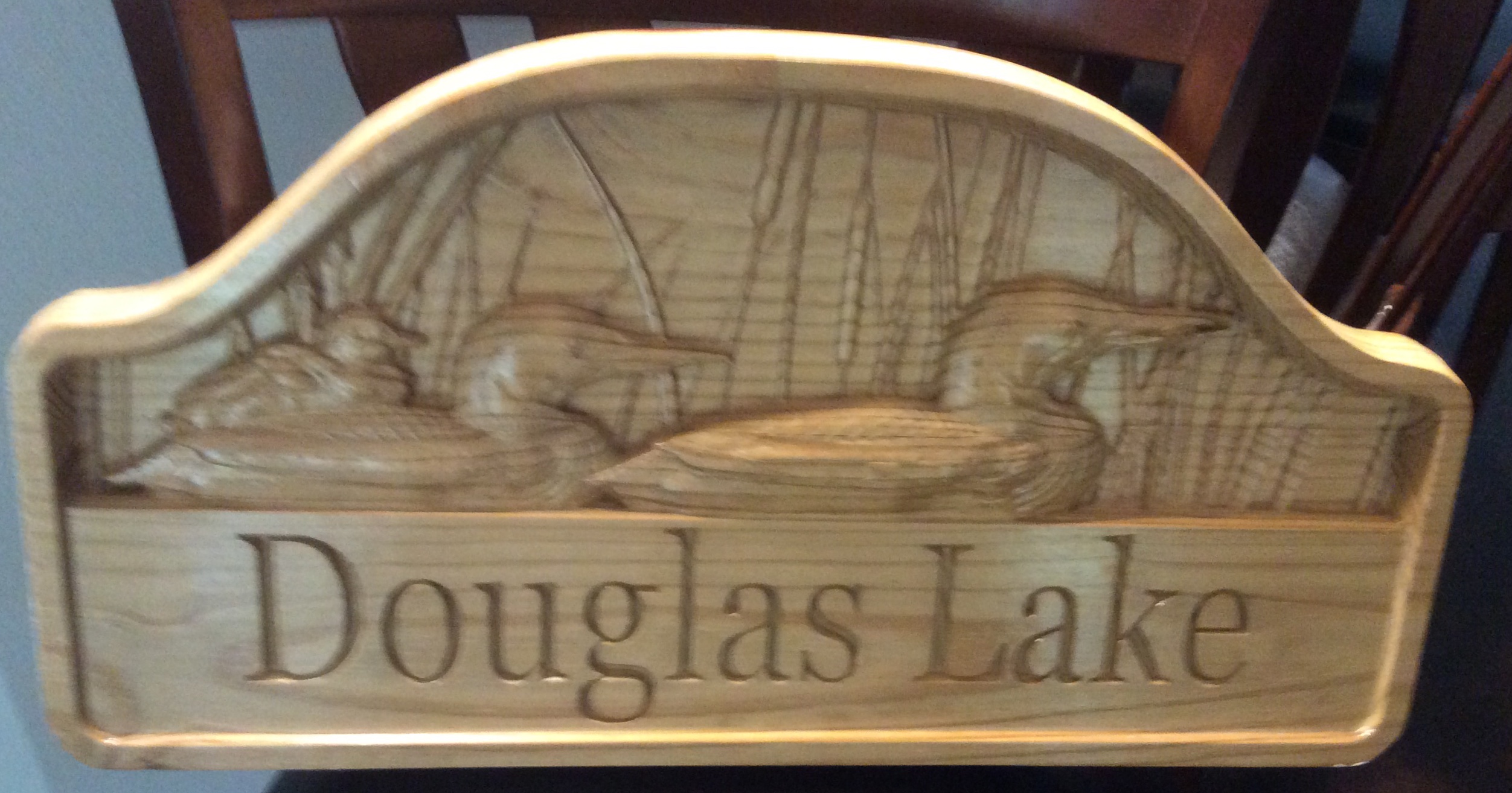

Are there any finished pictures of this?
Turned out really nice…
