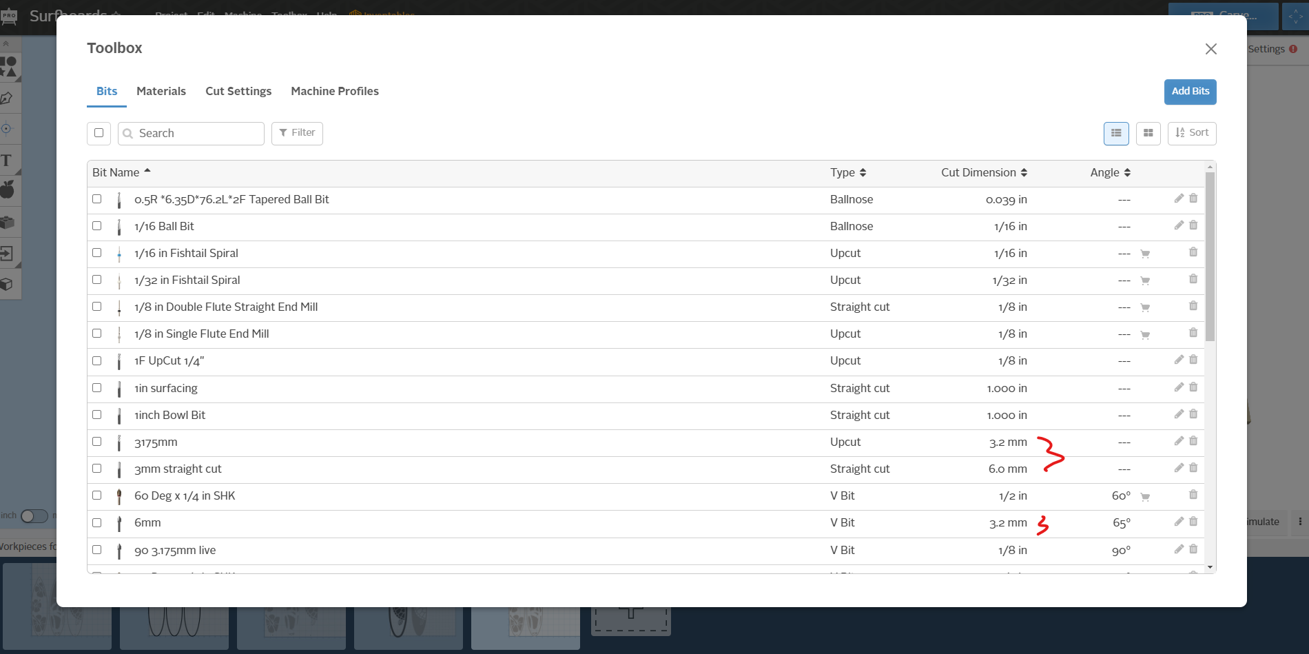

  1. Material Type, includs specific cut Settings?
  2. there are no Pearl inlay material in the list ?
  3. is it possible to view the Bit size in milimeters?
thank you so much and apologizes if the questions are 100 times answered, i cant find any suitable :slight_smile:

Bits Within the toolbox show the units that they were created using, you can enter custom bits and type the size in mm and it will save it to your library as such.
For Example see the marked bits here in my library, I would have typed โ€œ3.2mmโ€ when creating the 3.2 mm diameter endmill marked in red here.
