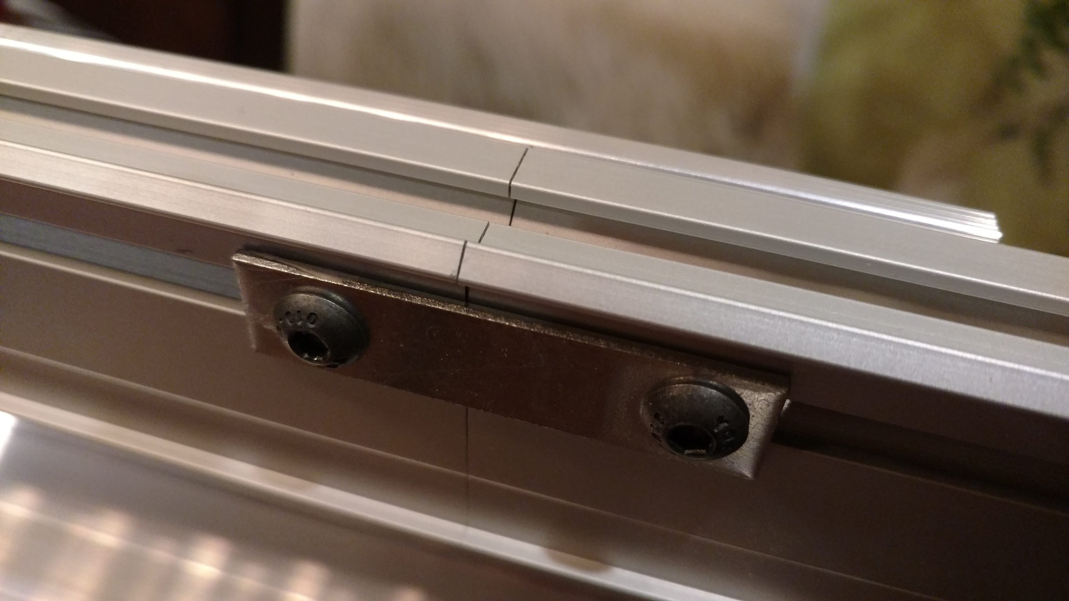

Angus, attached pictures of the bump. Just quick assembly to see how bad it will be. I can hardly create any motion at all in the joint and hardly can feel the gap with my finger. I think this will work just fine.

Wondering if you cut the ends of the makerslide yourself prior to joining them?
I don’t trust my old chop saw to do a precise enough cut, so I am hoping I can just join the pieces as they are when they arrive. Otherwise, I’ll have to call in a favor to use a friends shop.
Thanks.
My Y axis is 1 meter and 1.8 meter together so I did not have to cut anything.
I had to cut my X axis and I had no issues doing it with my saw.
For some reason it is made look like some mystical skill on forums etc. I purchased new diablo 84 tooth finishing blade. Armed myself in glasses and gloves, can of WD-40. Said good bye to my family and hugged my dog for the last time. Clamped my extrusion with biggest clamps I could find and did some test cuts on some 4x4s to see if all is square.
After my first extrusion cut I was seriously disappointed how easy and uneventful it was, 30 minutes later I was free hand cutting rest of them.
Just make sure to protect your eyes, I had tinny shaving bounce around my glasses and hit my eye, god that hurt like hell !

how did you bolt them together? so that there was little to no joint in the middle that would cause a bump as it travels over it

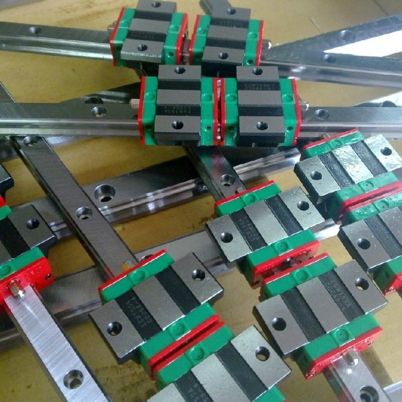

, someone experienced mount an X-carve on Linear Guide? or know of incombenientes? Thank you
