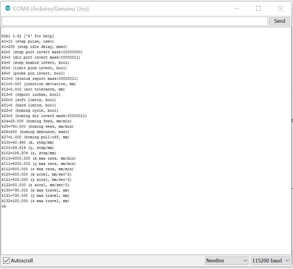

Entered in $$ in Arduino IDE.
Nothing happened.
Did you change the end of line to “newline”. Enter after $$ or press the send button. Baud rate at 115200
Did the serial monitor print out Grbl 1.0c [’$’ for help]
yes. and set baud rate per comments.
Is the gShield back on?
Nothing in the serial monitor. No reaction from IDE.

Here’s my Arduino IDE after opening serial monitor, setting the baud rate, and entering “$$”
Also, when using Xloader, did you select the Uno as the device?
When first opening serial monitor you should see just this:
Certainly not seeing anything like your list in IDE Serial Monitor.

Try this one just for testing - I know its history.
https://community.inventables.com/t/xcarve-jtech-grbl-update-bug-fix/28943
Ok. Now i can see something in the Arduino IDE!
So awesome… if that helps, that is.
Next step? Put on Gshield and power up?
Yes, put the gShield back on and run the same test again.
The 1.0c HEX file from Releases · inventables/grbl · GitHub worked for me and loaded. I know some users have had issues with 1.0c on the Arduino/Gshield.
There was a HEX file linked at http://bit.ly/1I8Ey4S which is the 0.9j HEX file that Inventables was using (retrieved from the history of README.md in the Inventables Github). I just tested it and it worked.
Looks like the Inventables hosted HEX file isn’t working right.
