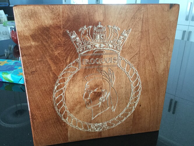

And finally, here’s the results…
I learned a lot, again. I used Inkscape to convert my png file to svg. I also used for the first time 1/32 straight bit and a 30 Degree V bit.
Beautiful work.
Well done sir.
That’s great … plus this thread is full of great tips from the community. I learned a lot reading it.
That is an awesome pair of plaques. The boat looks really good.
