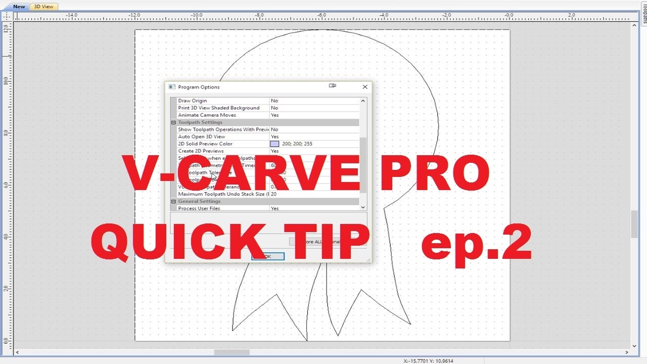

\also checkout my video on the toolpath tolerance setting
[![](https://img.youtube.com/vi/Pfb-C9bspPE/maxresdefault.jpg "V-Carve Pro Quick Tip Ep.2 (Tolerance +more)!!") ](https://www.youtube.com/watch?v=Pfb-C9bspPE)
