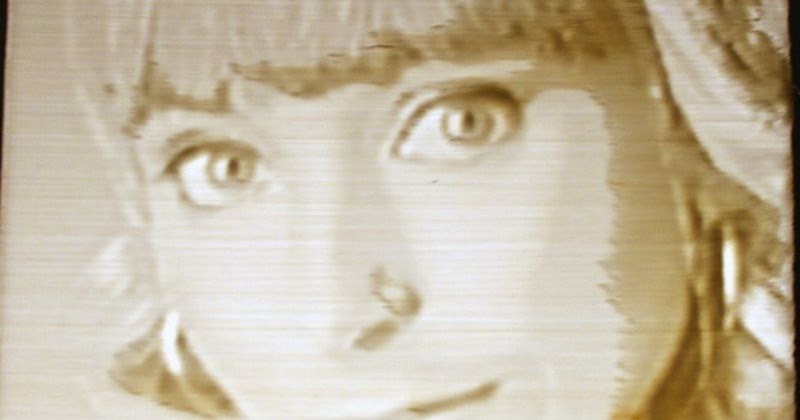

> **[Holy lithomania batman!](http://3dprintergear.blogspot.com/2012/09/holy-lithomania-batman.html)**
> We are always trying to improve on the 3D printing experience. This is a documentation of our trials, be they failure or successes!
