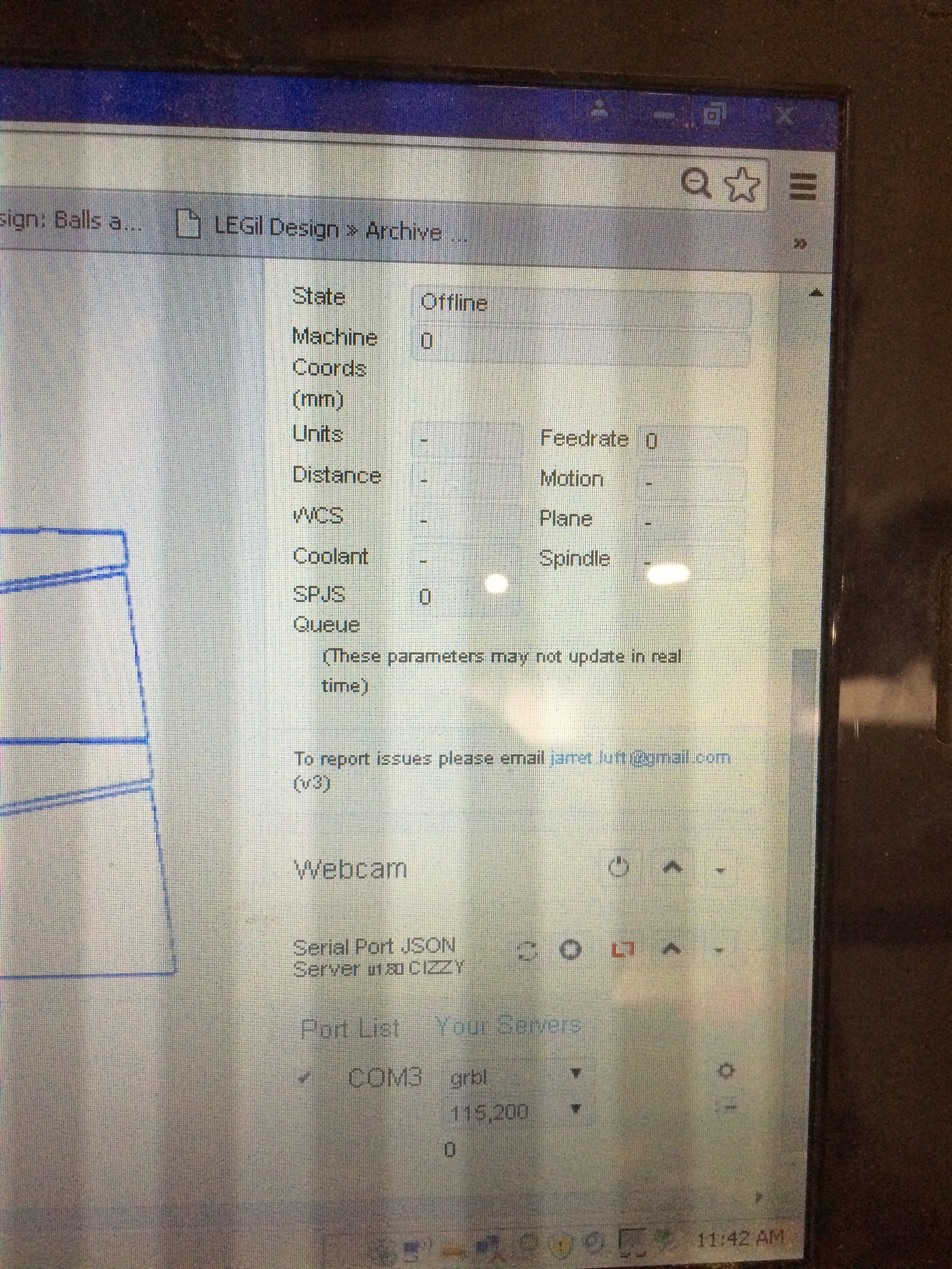

no has yet to explain why within a matter of seconds it went from working perfectly to not working at all… of course i can’t find my powered usb hub and i don’t have the money to buy one. Using my social media contacts to try and rouse one up I could borrow in the meantime… Is there a reason I can see the com port in the device manager but nothing can seem to find it???

@sketch42 it says it can’t open port. so obviously its a port issue. now i guess i just wait until i can get some money together to buy a powered usb hub and see if that does the trick…

so i finally have had time to deal with this crap some more, i spent the $20 on a powered hub @alandavis it didnt work, moving on. @sketch42 so it doesnt see my port when i try to flash arduino. When i go to device manager it shows my arduino uno under com3, the json server says it sees port 3, but i cant connect. YES I have tried through easel, but it just sits and spins when i type 3 in the com popup. @Zach_Kaplan

no luck with removing the gshield. xloader still says can not find port
