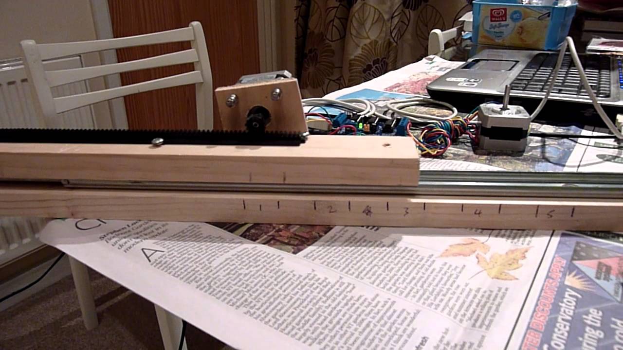

What i would like to do if possible is to open and close a drawer via a press of a single button.
The reason im asking here is that after a upgrade to X Controller i have a spare Arduino and gshild with 4 nema 17s .
so is it possible to do ?
Not sure where to start so if anyone can point me in the right dirrection that would be great .

Its quite possible but for a drawer it may be excessive. The electronics are going to take up a lot of space. Remember you will need a power source for the stepper and most likely limit switches. If you hard code a distance for the stepper to move and for some reason it looses steps, as when this happens on the X Carve, the results to your drawer could be less than desirable. Essentially what you are looking to build is a linear actuator or something that functions along those lines.
> **[V-Slot® NEMA 17 Linear Actuator Bundle (Lead Screw)](https://openbuildspartstore.com/v-slot-nema-17-linear-actuator-bundle-lead-screw/)**
> SHOP NOW - Pre-Packed Bundles - NEMA 17 Linear Actuator Bundle (Lead Screw)! Fast Shipping from U.S. - Genuine OpenBuilds Parts - #1 Open Source Hardware
or
[![](https://img.youtube.com/vi/oZWyZS4YiP4/maxresdefault.jpg "Traverser mechanism using drawer runner, stepper motor, Arduino UNO and Adafruit shield") ](https://www.youtube.com/watch?v=oZWyZS4YiP4)
I’m far from the most experienced with these types of electronics so if anyone else has any advice please chime in. It just seems to me that there are simpler and much more compact ways to do a project like this. You can see here how complex the systems to do this get in order to make them smaller.

Thanks for the info.
Looks like a linear actuator with Internal limit switches is the best way of doing my drawer .
