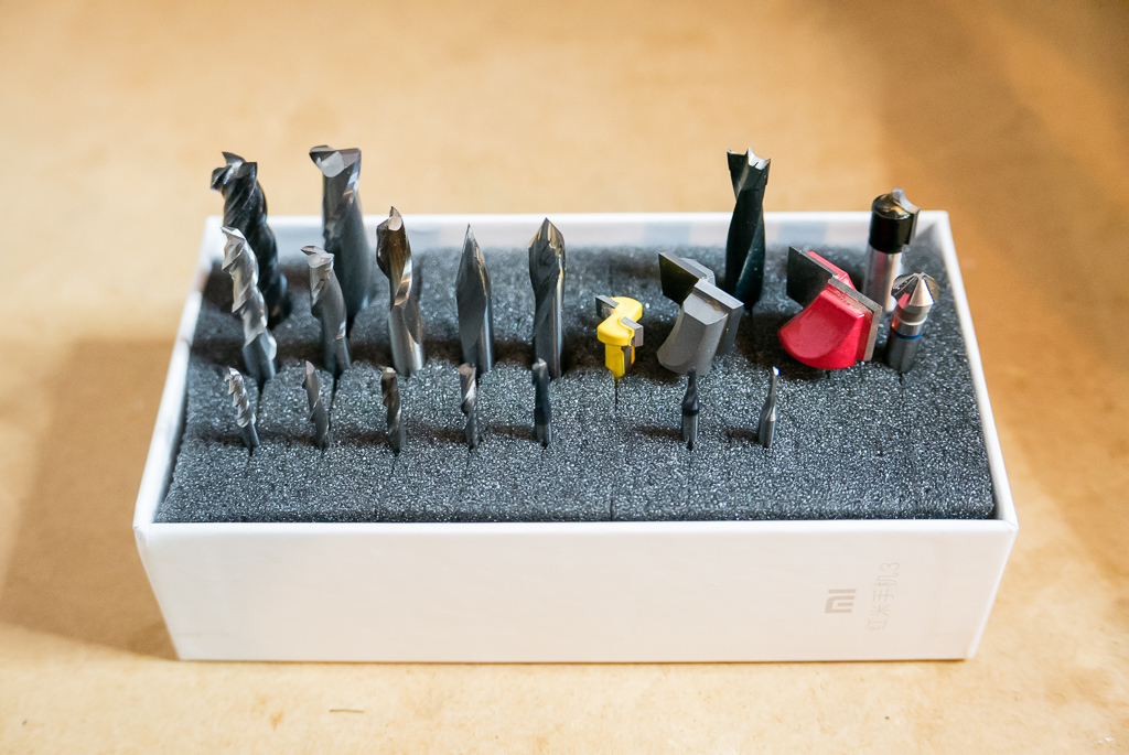

Also took some time to organize the end mills from a pile of chaos to something more functional.
It’s one of these rare times you get to use crap you didn’t throw away. This is excess pick n’ pluck foam from a Pelican case.
i have some of that stuff. Thanks for the idea.
