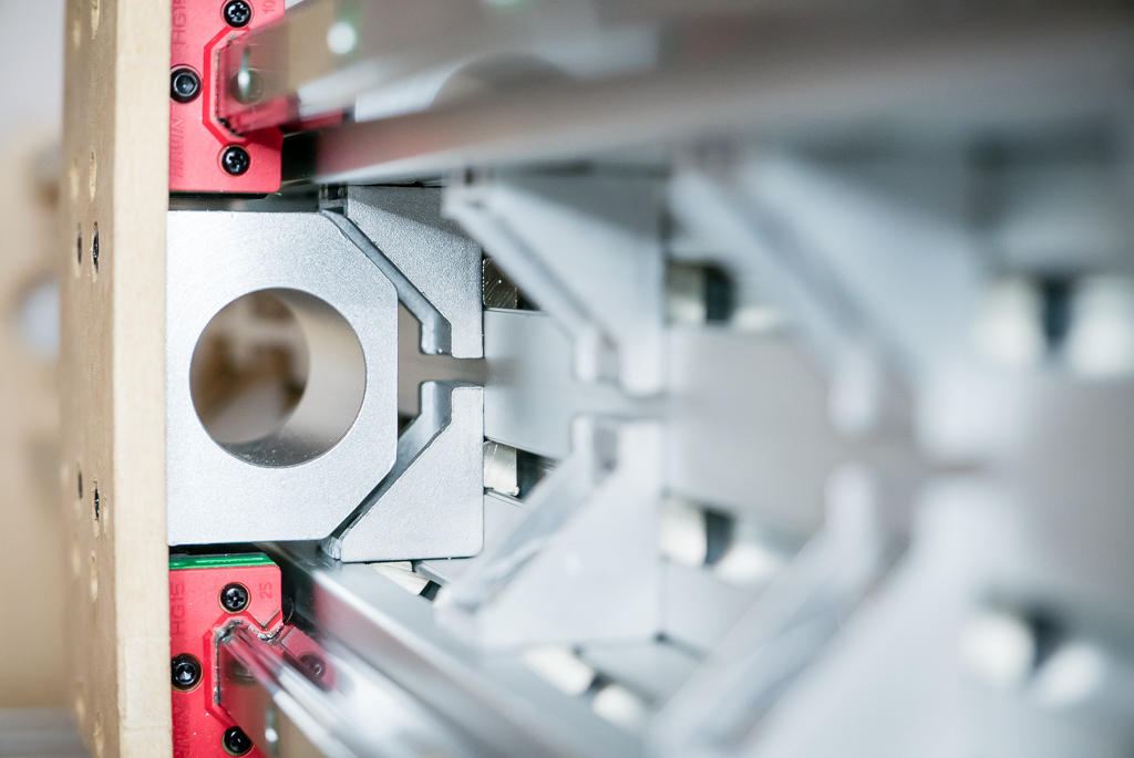

The gantry brackets arrived. Installing them was kind of a subproject. The reason was that the ones that I picked due to their dimensions being a good fit for the gantry were designed to fit parallel to the slots.
I wanted to install them perpendicular to the slots which meant that I had to remove 2 fins per side in order for the two planes of the corner to sit flush with the extrusions.
I used a spare 20x20 as a lever and a pattern bit.
Nice and flat.
Then I trimmed the front of one side by a couple of mm to give some more clearance. This time they were processed in parallel.
Good fit, good clearance. There’s some parallax in the shot, in reality they ballnut housing is centered.
Subproject finished.
