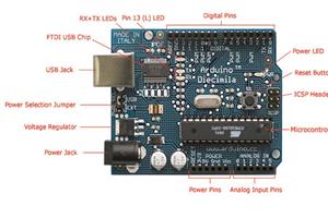

If you use an original Arduino Uno or a fully-compatible analogue board, the power source is selected automatically. The board has a MOFSET switch, NDT2955 (if I am not mistaken), which selects the external source, as soon as the jack voltage exceeds about 7.2V. Thus, no board modification is necessary as soon as your external power supply is at the nominal (my supply is 9V as measured on the open socket and written on the label).
Cautions:
(1) some cheap Chinese “Arduino-compatible” boards have no automatic power source selection! That’s the price we pay…
(2) unless you are absolutely sure what you are doing: never power up Arduino via 5V pin! Use the power jack or Vin pin, or you toast the on-board supplies.

Anyhow, the original Arduino Uno may be modified to work from the external power only. Don’t cut the wrong line. You are after USBVCC supplied from C4 via fuse F1.

If you are planning to use this shield anyway, why don’t you simply solder a 7809/LM340T9 and a capacitor to it, so Arduino is powered via Vin pin? And all your worries about the Arduino power are solved, even without external power supply and the jack.

Ok, you can eliminate the power from the USB cable by disconnecting Pin 1. Leave the other pins alone, they are ground, D+, and D-. You can still operate your machine and you don’t have to change the circuit on the Arduino.
Then you can use your external power supply to kill power to the Arduino and gShield.
I haven’t tested this, but it should work.
