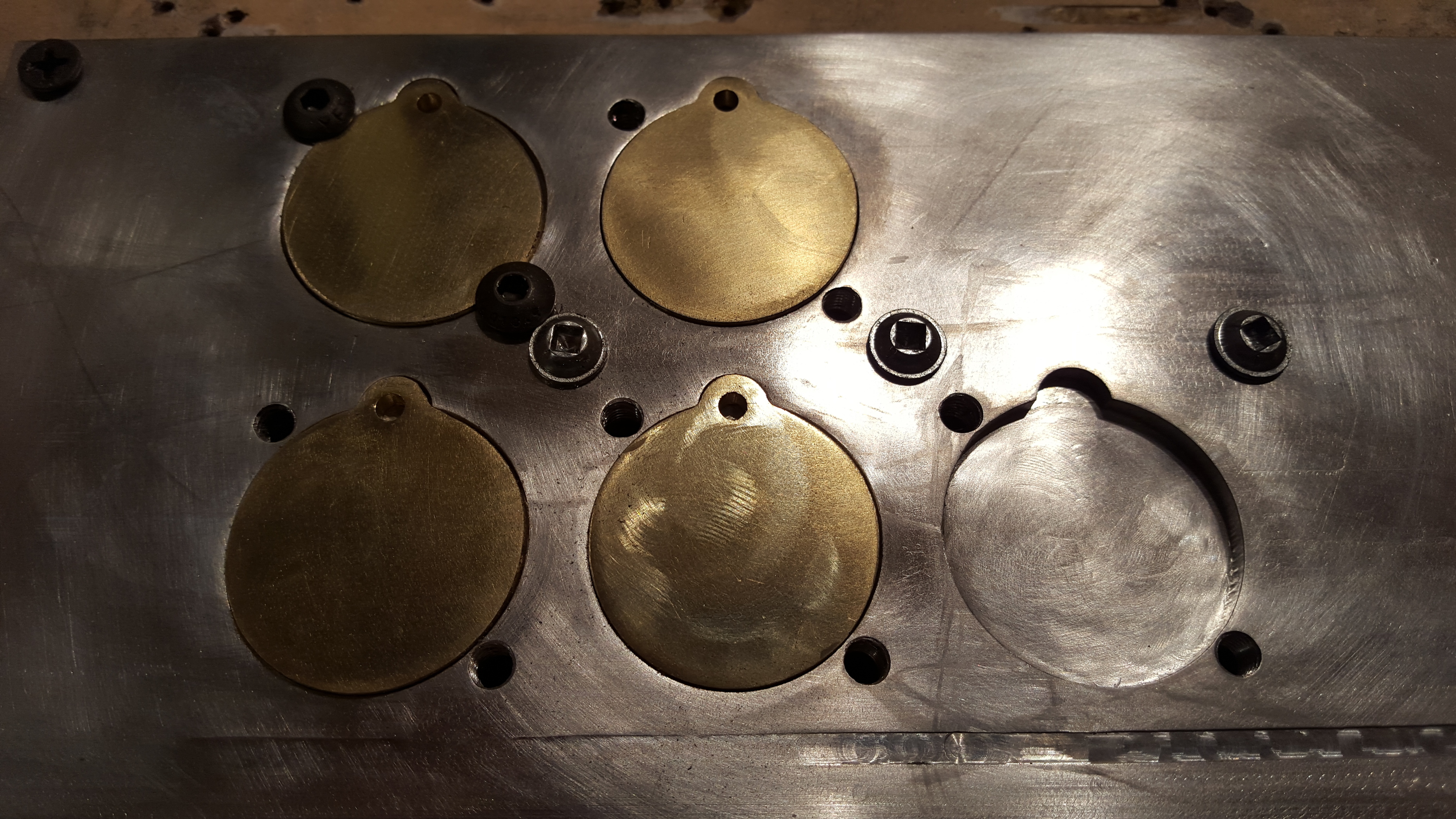

Not a single one. Plus, I do it differently nearly every time. Here are some progress photos that might give you an idea of what is happening:
This is engraving after facemilling on the Tormach:
Here is profiling (cutting out) on the X-Carve after engraving:
Here is a jig I made to engrave several tags at once on the x-carve:
Here are those tags, finished and in a custom wooden case for my customer:
