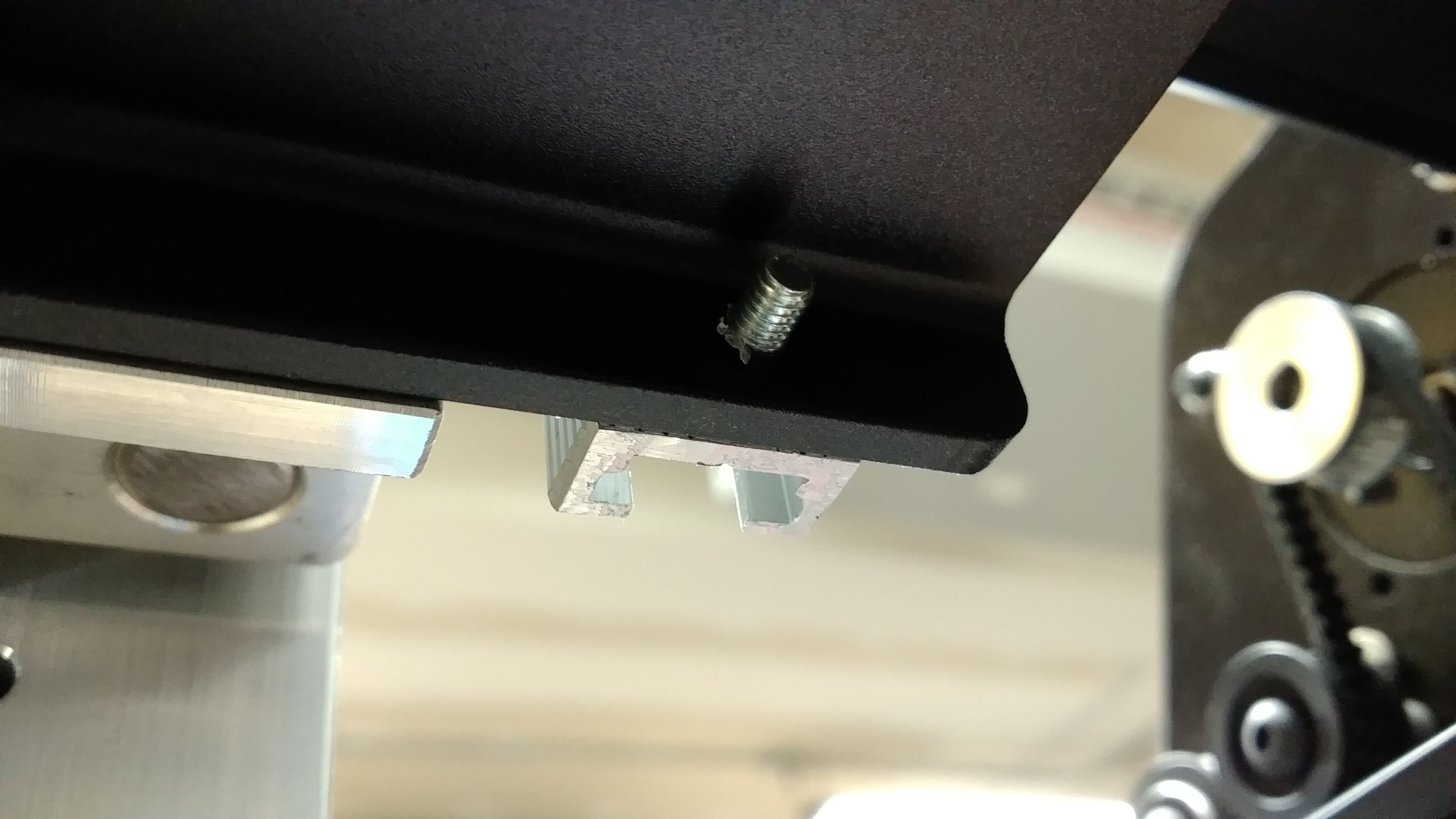

Would you mind snapping a pic of your finished dust collection rails mounted?
Sure, camping with scouts today so it’ll be tomorrow…
Awesome. I am about to pull the trigger on the Slider and a 269oz for the Z…but wanted to see a few ways of mounting the inventables dust control first.

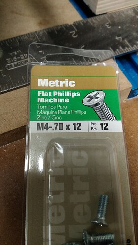

So I have the suckit dust boot, however here’s how I attached the rails …
I basically cut the brackets so they are flush with the bottom edge, and with enough clearance at the top so the right side won’t interfere with the plug for the probe (mine is an older version that didn’t have the plug, but I wired one up myself)
Then I drilled and tapped with an M4 tap (from Lowe’s, the package gives you the bit size you need) and used flat Phillips machine screws
Take your time drilling and tapping, I did it directly on the machine
The top screw is just high enough to make it over the top face of the carriage, and the bottom is just under
As for left right spacing, I just bumped them against the screw heads for the V wheels
clever.
countersink bit from Lowes would help sink the heads on the screws and break the burr on those threads.
I actually did countersink, however I was worried about blowing thru the back of the rail since it’s very thin, so I didn’t countersink completely, which is OK since the arms of the dust boot fit as-is…
If I were to do it again I’d likely thread the rail and run the screws in from the back, but it works and I haven’t had an issues.
I bought replacement T-slot from McMaster-Carr. It had holes pre-drilled and counter-sunk for attaching. I just had to cut it to length.
