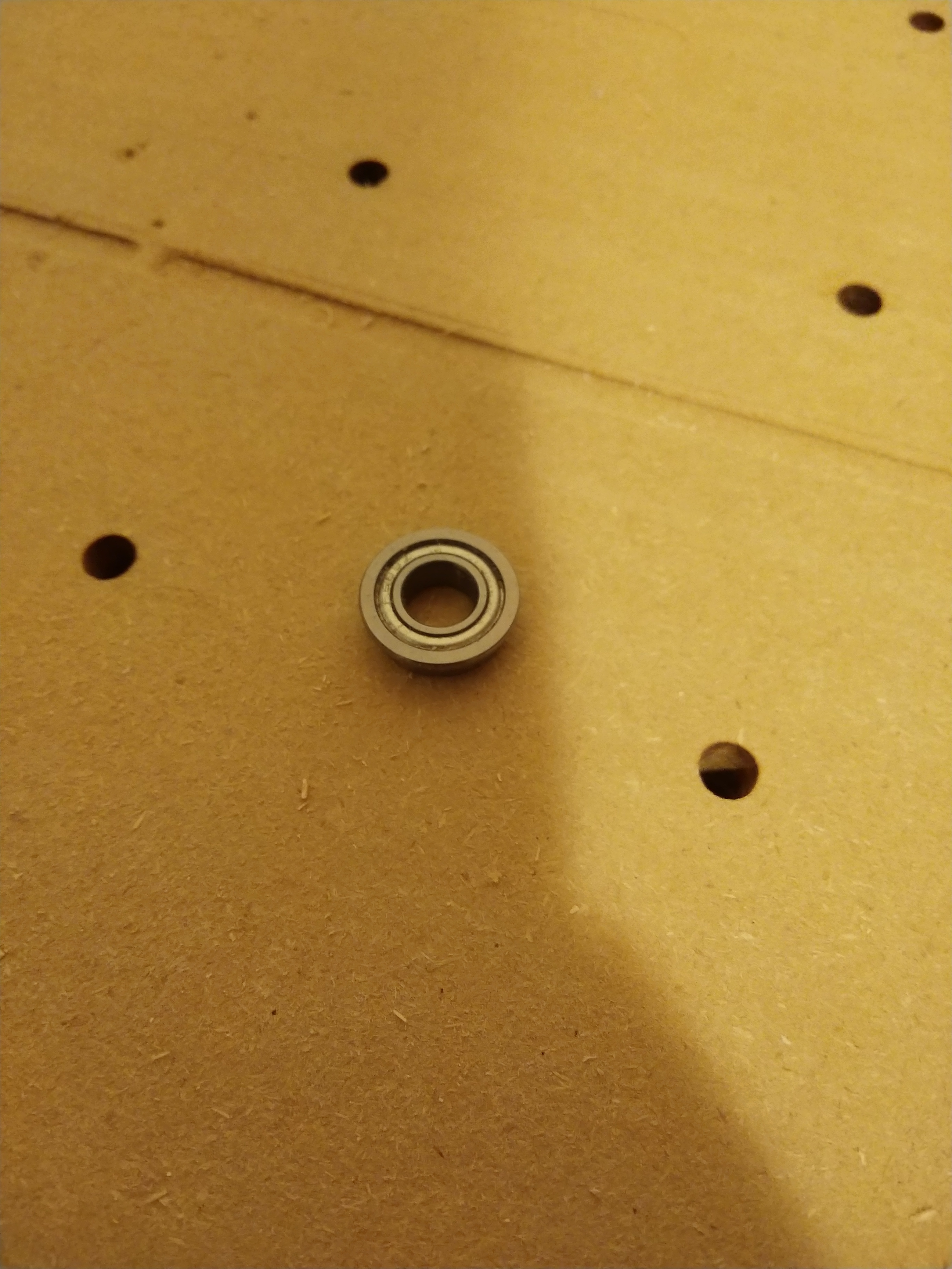

Part way through mounting mine, I noticed that with the router attached, the axis slides all the way to the bottom. That is to say, when unpowered, it doesn’t hold its position.
That’s not right, is it?
Perhaps related, found this piece on the floor next to the package:
Can’t figure out anywhere it might go, other than perhaps here:
Anyone else remember from installing theirs?
I have experienced the same but with ACME rod, direct drive home-built Z. Sign of low friction :slight_smile:
Cool, thanks!
Got things put together and found that I’d trimmed my Z motor wires like a lot of folks have. Was looking around for wire but figured I’d just upgrade all the motors. Found some on Amazon and they’re arriving tonight :smile:
Joe also confirmed for me that the bearing I found sits on top of the screw, so all good there.
