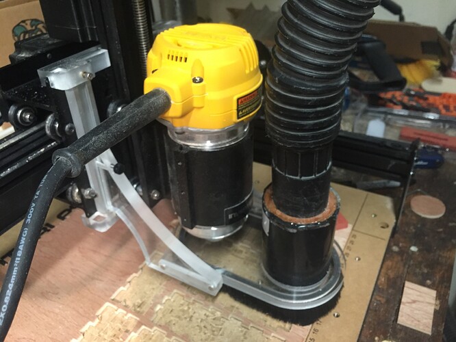

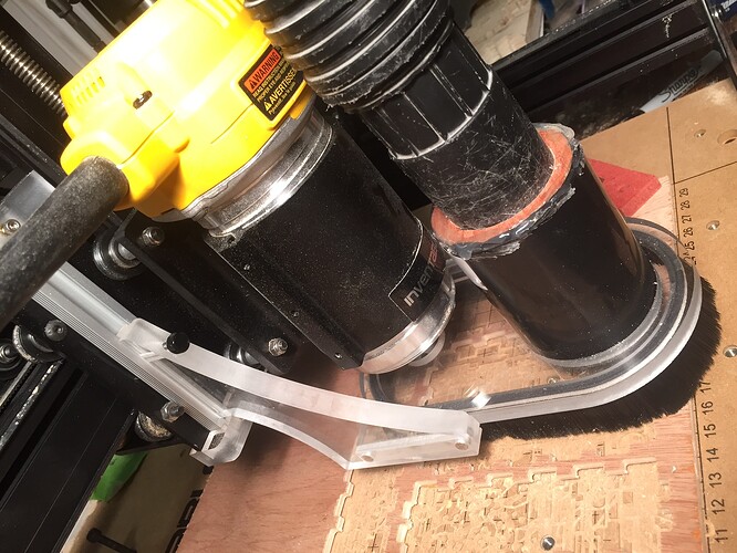

There’s no adjustment available left to right, I have the stock 611 in the stock spindle mount. I can twist the spindle all day long, it wont matter, the bit is not centered on the hole, look at the final pic. I have to cut that hole bigger, and we all know how much fun that is and how crappy it will look

I’d love to know which one is not centered, the bit or the Suckit hole.

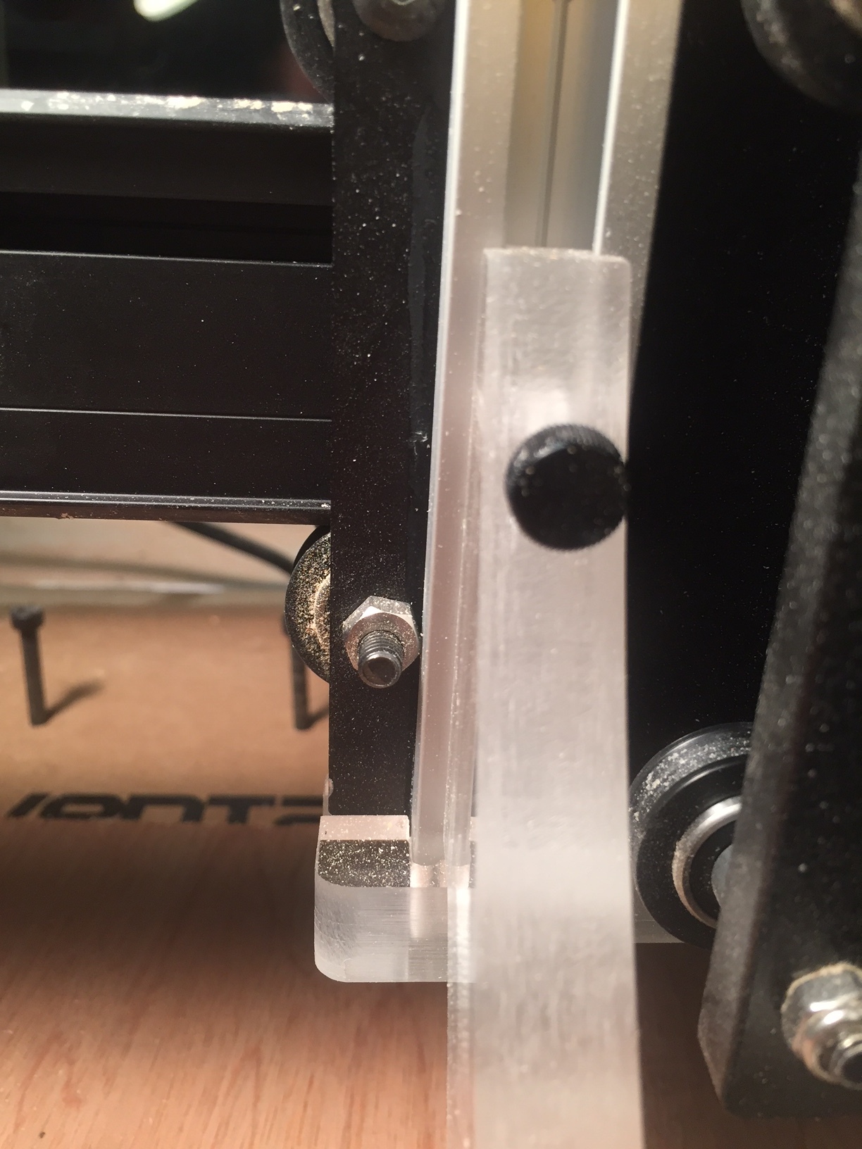

Hey Darryl… So sorry to hear you are having issues. LarryM informed me of your post. I have reviewed your pictures and tried recreating the scenario . One thing I found was that it is possible that your Z-Axis makerslide is not centered on your X-Carriage. There are 4 screws that hold the makerslide to the X-Carriage. if you loosen them you should be able to center your Z-Axis. Can you please let me know if this helps. Also, can you please take some measurements of the dust shoe center hole and let me know what you find.
I’m sorry to hear Darryl is having issues. I just received mine as well and it went together quickly and with no problems. After looking at your pictures is it possible that your Z-axis maker slide is not centered on your X-carriage?
Yeah, not much slop there at all, already tried with no success. I’ll take measurements when i get home and send over.

OK, thanks… Can you also take some measurements of your Z-Axis makerslide position to the X-Carriage edges?

Is this an optical illusion, or is your spindle not vertical?
Optical illusion, angle of the photo. Spindle is dead straight.
So I checked further. The hole is dead center in the acrylic, 25mm diameter, looks great, and if I let the carriage drop to its lowest position and don’t tighten the screws it looks centered, but if I try to raise it and tighten the screws, its off center. I’m going to pull the sides and try shimming with a washer.
