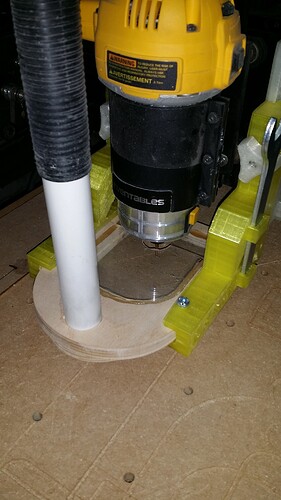

The dust shoe looks good, Philjohnson. I was building my 4th one and then I saw your design but your L brackets were too big for my 3d printer so I had to design them from scratch( It was my very first 3d design) so it took me a while. Mine looks similar to yours except for my t-tracks, I designed those so they slide on the gantry and get tighten with a couple of screws, I didn’t wanna drill more holes in it. my shop vac is really small so is not as strong as yours but I will upgrade that soon. But Im happy with it. Thanks for posting your drawings, they really helped me a lot in my design and the “suck it” design too. More than likely I will buy that too just to have it I guess.
Seems like alot of weight hanging off the Z axis.
That thing is not heavy at all. That was my first thought when I saw phil’s but when I was finished with all the parts and put together, it wasnt heavy and the front hanging is not bad either. I made those parts only 10% infill, so that helped with the weight too.

I wish I had a 3d printer tho machining this on wood working tools and the XCarve made for a cleaner look. I only hope it works as well as it looks…
What keeps the arms from sliding down the blue track? And how do the blue tracks attach to the gantry?
I second this question
I actually drilled and tapped the t track to the bracket while it was on the machine - and the weight of the shoe on the arms is almost enough pressure to keep it in place but I am going to drill and tap a tightening screw thru the upper area - it does not have to be very big and I will be using a small thumb screw or possibly a knurled screw if there is room.

Thick acrylic is kinda hard to come by around here as well so good old plywood will probably be incorporated with a viewing window.
Kinda of holding off though as i am considering an upgrade to the z axis like what is found here.
Hard to see thru Plywood
The original prototype I made had arms of Oak and a plywood dust shoe I even cut out a square viewing port dropped in a piece of plexi it seemed too weak with a groove cut into it but now with the brush channel I screwed to the side I think wood - would work fine.
