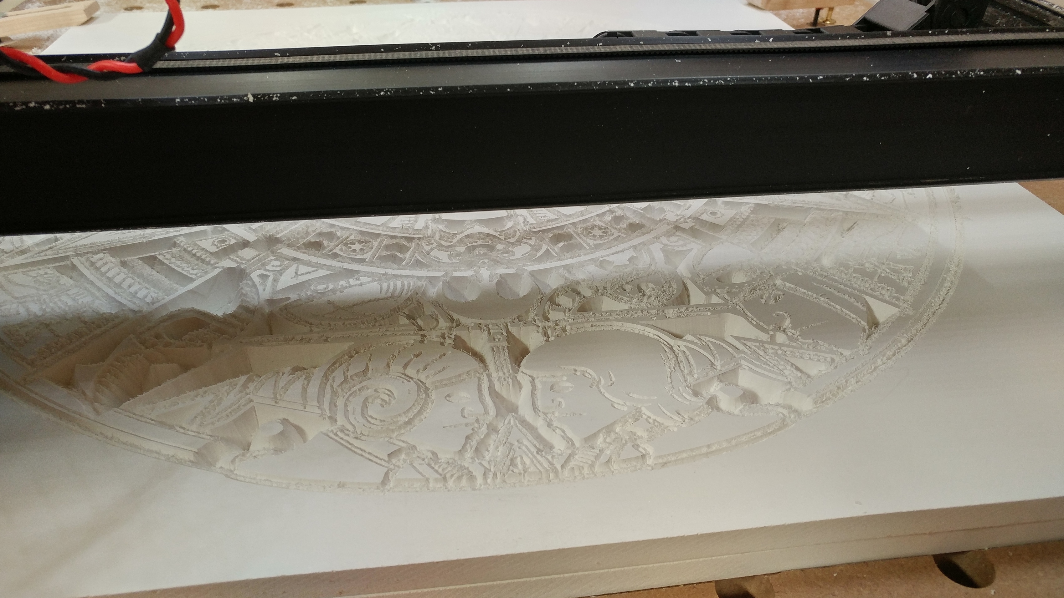

After several MDF attempts with final success , i decided to step it up a notch and create the dial on sheet pvc.
I looks pretty good I think, my only issue is the remnant pvc pieces that have refused themselves to the carve.
Settings 60 degree v bit, 100 ipm, .0625" per pass
The carve took approx 9+ hours, i am thinking about running the carve again (with a deeper per pass amount, to speed the carve up) to just clean out the debris, (or the old fashion way of picking out all the extra pieces with a little scraping tool)
Any thoughts or ideas would be helpful
You don’t have a dust shoe? And yes all my vcarve I run twice.

You’ll need to use a program like vcarve to create the gcode to send it to the xcarve
Ok, I did the Aztec and the starwars, but both came out with much more detail and less surface area than what anyone here is showing. will attch pic.
can someone please tell me what I’m doing wrong. is it from when I I upload this file from the web?
sorry if this has already been answered
When you create your v-carve toolpath enter a flat depth
they are both inverted.
i.e. you carved away what is supposed to be left untouched, and vice versa.
The easy fix is to draw a circle around the whole thing and let it rework the toolpaths.
Or, if a circle outline is already there, delete it.
I don’t know what software you use, but a preview window is a machinists best friend
need to select all vectors then deselect the outer most vector
