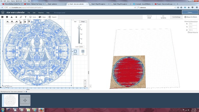

  1. damp rag with? —2hrs that’s good
    what size of bit did you enter on easel?
    which is better 60* or 90*?
Easel cannot cut this design it is V-carved
Water
Did not use Easel - I used VCarve Desktop
I used a 60 degree vbit. I never tried it with a 90.
Technically yes it can but your not using easel your just using it as a g-code sender , he asked what bit to enter in easel that’s why I said it can’t be cut in easel I guess I should say the job can’t be set up in easel you must use a cam program capable of v-carve toolpaths.
Easel cannot move the bit up and down like a v-carve does for the paths. If it could that would be a great improvement.
So they added Vcarving to Easel now?
oh. hehe its been a while since I even used Easel.
:stuck_out_tongue:
i will be using a 60* vbit on 1/2" mdf.
this was imported as svg to easel, if this is wrong kindly show/give a step by step diy.
