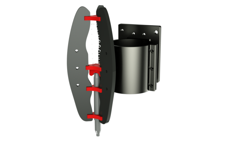

i am planning on posting mine soon. it’s a sharpie holder with a spring to account for any height changes in the material.

The instructions are rough right now, but I hope they get the point across. However, if enough are interested, I will refine the instructions and do photos.
Haven’t tested the easel file, as I had made this in rhino and used rhinocam/ugs to cut it.
Enjoy!
Any significance to the red part in the SVG? What about the one towards the right both rectangular and round profiles in the center?
no significance to the red curves in the svg. the rectangular part has to cut all the way through while the circle is a small recess for the spring to fit in. That part faces up when assembled. the other one with a circle (referring to the diagram, second from the left in the layout pointing to the top part) faces down when assembled. It too is recessed. this also will give an idea of how large the spring was that I had used. It is a light spring so it gives more than enough to allow the pen to go over changes in the surface.
ok, just realized that the diagram didn’t upload. I’ll reupload it and make sure it works.

ok so, it was uploaded, however I just hadn’t selected it to be viewed with the instruction. here is a direct link to it (not sure if that will work, but it is visible in the instructions now.
I also want to note, that these tolerances are really tight. it should be adjusted based on how well your machine handles tolerance. the rings that hold the sharpie should be just kissing the outside of it so it can still glide but stay pretty well in place. I ended up having to sand mine and using a critical fitting device AKA a rubber mallet. This was my first cut and it showed me that my machine was pretty off to start with.
FYI - having battled the close tolerance issue before, you can also chuck your sharpies into your drill and sand them down a bit. It is often easier to get the tolerance PERFECT this way. Plus, you will know which Sharpies are for your machine and therefore should not be stolen by your spouse or children - another battle.
