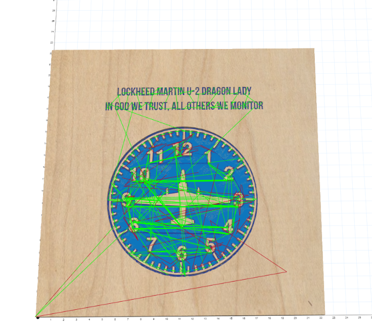

Are you probing in the same spot with each bit?
@BlueLocktite This is one of the tools that is awesome for quick analysis of the toolpaths.
Yes, exact same spot, that being the hone position.

Thanks, Jeff. I did open a ticket with support yesterday and provided the g code and the end results.
I don’t think these carves were very complicated or outside the capabilities of Easel Pro. I want to have confidence in it as it is easy to use and I like the interface.

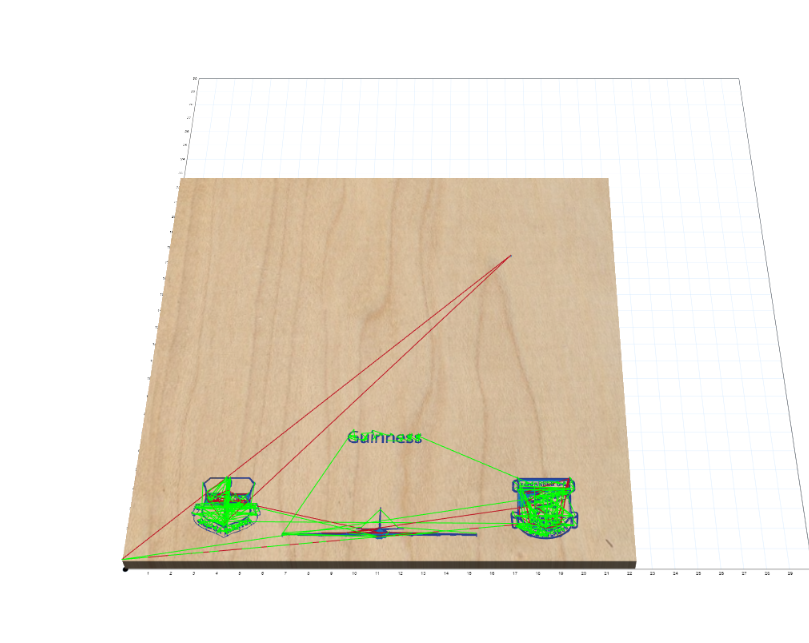

Split one of the crappy cut projects in two. Seeing some anomalies in the preview with Easel Pro sending the router to places where there is nothing to carve.
I’m super paranoid now. Anyone have time to take a look?
Gcode for the 2nd carve (the small emblems)
Guinness_detail (1).nc (4.8 MB)
Guinness_roughing (1).nc (385.6 KB)
Those locations happen to be where there are things to carve on the other half of the project. Did you accidentally not delete all the shapes in those spots?
When I go into the project there is nothing there to delete.
I am not seeing that issue when I simulate paths:
That is very strange. I haven’t heard of anything like that before. Our engineering team will take a look at this tomorrow.
FWIW, I see the same thing as @JeffTalbot
Edit: Ran it again and go the extra plunge.
So I closed down the browser and opened up Easel Pro again. I just ran the Simulate and this is what I see now.
