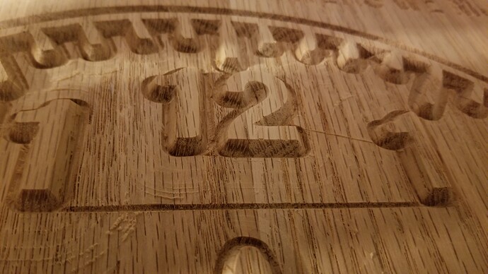

Rough cut went fine. Ran the detail cut with a 60 degree vbit and crap city. I did a cut yesterday and no issues. What could cause the bit to drag like that?
 ![20180318_192228](https://canada1.discourse-cdn.com/flex009/uploads/inventables/original/3X/d/0/d0eb1a7077106be8c843e0d9cb0b68444aff904d.jpg)
![20180318\_192256|690x388]
(upload://7ceqQ36zfU2838OeYFkODGP9LpS.jpg)
 ![20180318_192247](https://canada1.discourse-cdn.com/flex009/uploads/inventables/original/3X/4/c/4c3ec14df933934924267ff224eb82cc3b2c44fb.jpg)

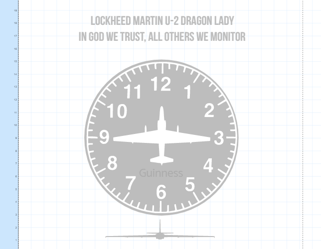

Here is the project. I can’t see anything in here.
Belts were all tight. Two bad carves in the last 3 days and I’m out over $100 in Oak.
> **[Guinness](https://easel.inventables.com/projects/Qzx7phcl350OC-lSS2Z47g)**

Looks to me like the Z for the V-Bit was lower than the Z for the roughing bit; either the Z-Zero was off or lost steps by a number of possible means. Just my opinion based on what the images look like. Looks like the final depth that the V-Bit cut to was lower than that of the roughing bit, but the final simulated tool paths for both appear to be on the same plane from what I can tell by looking at them in EASEL.
(:0)

Line 72823.
Goes from the 7 to the 6 at a depth of 0.2", your max cut depth.
I think this is a bug. That should be a travel move, and I think the bit should raise to 0.15"
Technically, if your Z was **perfectly** zeroed, that line wouldn’t exist as it was roughed to 0.2" with the roughing pass.
> [@PaulRinguette](#):
> I used the Z-Probe before each cut.
Your V-carve is a decent amount deeper (not in the code). Where are you probing?
I’ve seen this before, and it looks like there are other threads popping up with the same issue.
Contact support.
 ![image](https://canada1.discourse-cdn.com/flex009/uploads/inventables/original/3X/b/2/b2b9aceef3ffeff8180be5fe537bded9a8c6dc7f.png)
